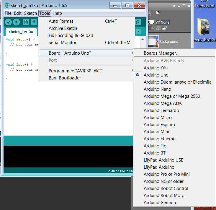

I uninstalled Arduino IDE 1.8.5 and finally found and installed 1.6.5
Same results with both 1.8.5.and 1.6.5 - NO Z-UNO board type offered.
Needless to say, I closed and reopened both apps.....

Have you managed to select and install the Z-Uno package? Can you paste I a separate thread your screenshot of board manager Z-Uno package record and Tools->Boards menu

Here are the relative screen shots. What is the package you are referring to? I have not yet received the ZUNO yet...ordered but no idea when they will ship?
- Arduino_BoardsManager.jpg (64 KiB) Viewed 121634 times

Looks like you missed the step with setting the URL in Board Manager.
Please don't miss steps 4 and 5 from this guide: https://z-uno.z-wave.me/install
