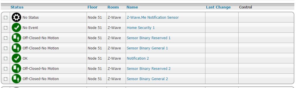

Included this into HomeSeer, It is not working in it's current form, I'm also not sure why the extra 2 sensor are populating the device?
