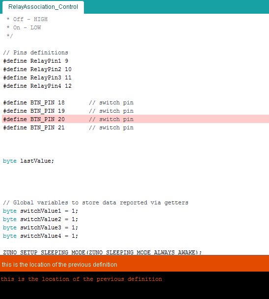

I've used the 4 Channel Relay example and want to add mechanical switching. NOt sure if I have used the correct method but I tried the Association Control example using Pin 18 to 21 for switching.
The sketch will not compile and returns an error
Association Control.jpg (39.43 KiB) Viewed 16985 times
I'm attempting not to use Pins 3 to 6 and assume that Digital Pins 18 to 22 are the correct definitions.
Re: 4 Ch. Relay with Switches Some help required with sketch
You are defining BTN_PIN 4 times! Use different names like BTN1_PIN, BTN2_PIN, ...

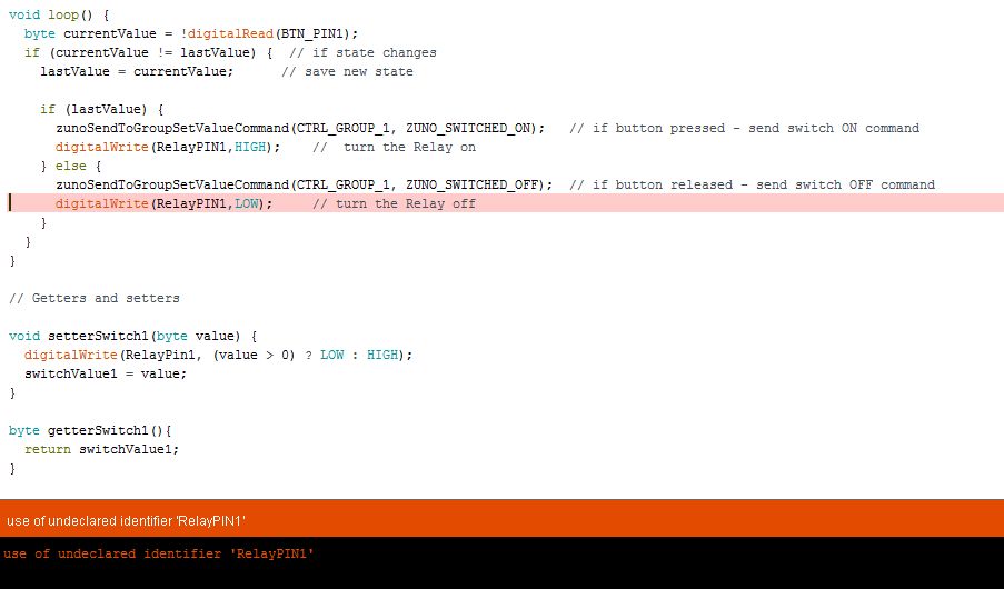

Next problem is definition again, this time in the loop.
void loop() {
  byte currentValue = !digitalRead(BTN_PIN1);
  if (currentValue != lastValue) {  // if state changes
    lastValue = currentValue;      // save new state
    if (lastValue) {
      zunoSendToGroupSetValueCommand(CTRL_GROUP_1, ZUNO_SWITCHED_ON);   // if button pressed - send switch ON command
      digitalWrite(RelayPIN1,HIGH);    //  turn the Relay on
    } else {
      zunoSendToGroupSetValueCommand(CTRL_GROUP_1, ZUNO_SWITCHED_OFF);  // if button released - send switch OFF command
      [b]digitalWrite(RelayPIN1,LOW);     // turn the Relay off
digitalWrite(RelayPIN1,HIGH) is defined, yet digitalWrite(RelayPIN1,LOW); is undeclared identifier
I also assume that this part needs to be coded for all 4 BTN_PIN (ie BTN_PIN 1 to 4)?
I don't see abt problem on the picture, but in the code above the picture I can notice a
LOW[/b]
Should be just
LOW

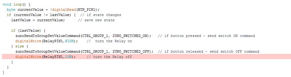

Post by Black Cat »
Association Control3.jpg (49.73 KiB) Viewed 16965 times
Looks it complains on RelayPIN1. Please paste the full current code.

Found it. I used mixed Uppercase and lower case.
