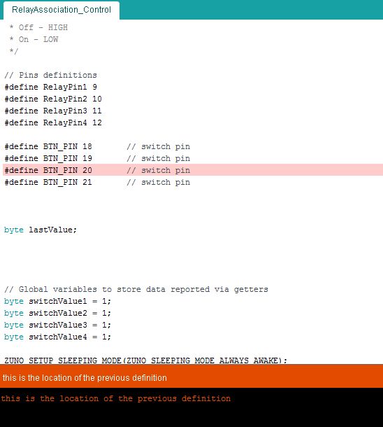

I've used the 4 Channel Relay example and want to add mechanical switching. NOt sure if I have used the correct method but I tried the Association Control example using Pin 18 to 21 for switching.
The sketch will not compile and returns an error

I'm attempting not to use Pins 3 to 6 and assume that Digital Pins 18 to 22 are the correct definitions.

You are defining BTN_PIN 4 times! Use different names like BTN1_PIN, BTN2_PIN, ...

Thanks, that part is now clear.

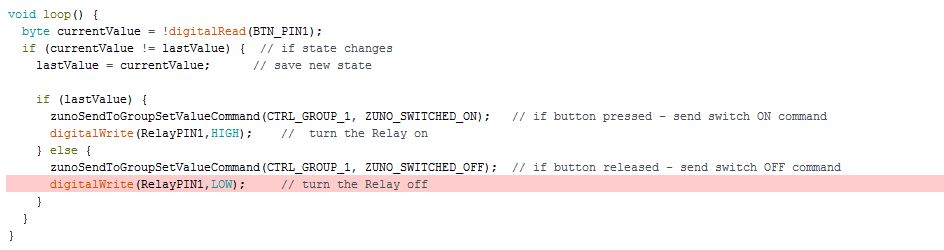

Next problem is definition again, this time in the loop.
void loop() {
  byte currentValue = !digitalRead(BTN_PIN1);
  if (currentValue != lastValue) {  // if state changes
    lastValue = currentValue;      // save new state
    if (lastValue) {
      zunoSendToGroupSetValueCommand(CTRL_GROUP_1, ZUNO_SWITCHED_ON);   // if button pressed - send switch ON command
      digitalWrite(RelayPIN1,HIGH);    //  turn the Relay on
    } else {
      zunoSendToGroupSetValueCommand(CTRL_GROUP_1, ZUNO_SWITCHED_OFF);  // if button released - send switch OFF command
      [b]digitalWrite(RelayPIN1,LOW);     // turn the Relay off
digitalWrite(RelayPIN1,HIGH) is defined, yet digitalWrite(RelayPIN1,LOW); is undeclared identifier
I also assume that this part needs to be coded for all 4 BTN_PIN (ie BTN_PIN 1 to 4)?

I don't see abt problem on the picture, but in the code above the picture I can notice a
LOW[/b]
Should be just
LOW

Looks it complains on RelayPIN1. Please paste the full current code.

Found it. I used mixed Uppercase and lower case.
