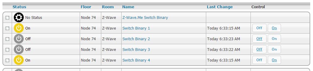

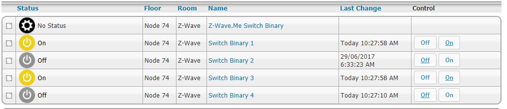

I attempted to clean up the code and add the extra 2 channels.
I find that UISwitch1 controls UISwitch4, also Button Switch 1 controls Button Switch 4.
I still don't see where the interference is as 2 and 3 work as is expected.
I think the coding is easier to read in this format, but I do not know if it is acceptable format?

by Black Cat
This is the UI when Binary 1 is switched ON. BInary4 indicates ON, but is not actually ON, it only indicates ON.
Perhaps there is some logic that can be added to turn the UI off? Not sure just thinking out aloud?

Now this really starts to get weird.
I had initially thought that it might be due to the PINOUTS and had today intended play around with them, but after I plugged the ZUNO into my PC prior to uploading a new sketch I thought I should check the current sketch.
What I found was that the UI indication when selecting Switch 1 also turned Binary Switch 3 ON.
I think that PIN 17 has something to do with this and intend to try different PINOUTS today to test this theory.
