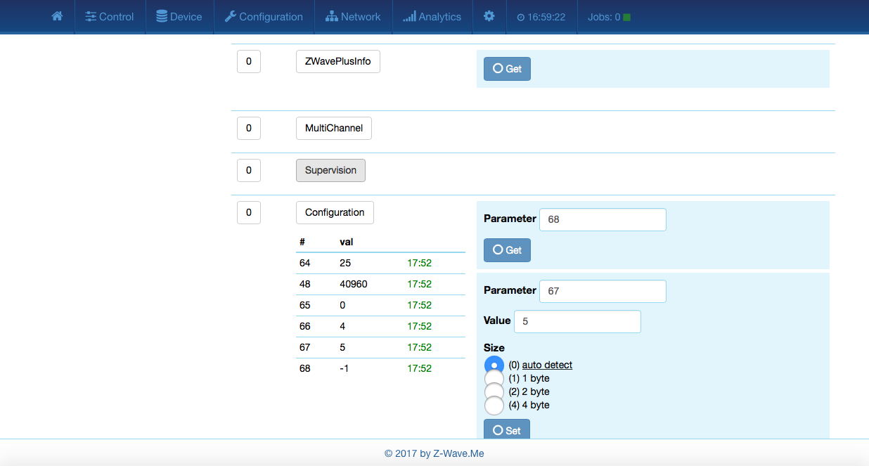

So, I tried your code. It works with my Razberry controller fine (configuration parameters work, I don't have a sensors I just comment all the sensor code).
See the attached screenshot.

It looks like I know the reason why it's not working on your board. May be you use the prerelease version(2.1.1 from test-ucxx). Please try to reinstall the latest stable version from the main URL(http://rus.z-wave.me/files/z-uno/packag ... index.json). To reinstall Z-Uno packages you have to do this:
1. Remove Z-Uno package folder from Arduino (sometthing like <...>/Arduino15/packages/Z-Uno and <...>/Arduino15/packages/staging/Z-Uno - you will see it if you tap to "preferences.txt" link in preferences window of Arduino )
2. Check that you have the right URL in "Additionals Board Manager URLs".
3. Install Z-Uno board (release 2.1.1) using "Board manager".
Alex.
Снимок экрана 2017-12-13 в 17.52.40.png (88.61 KiB) Viewed 18325 times
