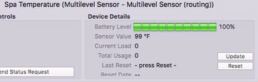

I've updated to the latest 2.1.1 and things are MUCH more stable, thank you!
However, when I do send a report, it shows up multiple times (anywhere from 4-6 times) in my controller's logs. If I enable debug logs that show the raw ZWave messages, they do appear to be coming in multiple times. Not a big deal I guess, but just curious why it might be sending the same report multiple times.

Just one channel. Here's a detailed report from my controller:
Indigo Z-Wave Version: 2.0.103
Node ID: 31
Model: Multilevel Sensor (routing)
Model ID: 01100001
Manufacturer: Duwi
Manufacturer ID: 0115
Protocol Version: 4.38
Application Version: 2.11
Model Definition Version: 0
Library Type: 3
Class Name: Multilevel Sensor (routing)
Class Hierarchy: 04 : 21 : 01
Command Class Base: 31
Command Versions: 20v1 60v4 85v1 86v1 8Ev1 70v1 31v7 72v1 73v1 59v1 7Av1 5Av1 5Ev1
Encryption Status: Not Supported
Multi-Endpoint Types: 1:(21 : 01)
Multi-Endpoint Classes: 1:[31]
Multi-Instance Counts: - none -
Features: routing, beaming
Neighbors: 5
Associations: 1:[1]
Config Values: - none -
