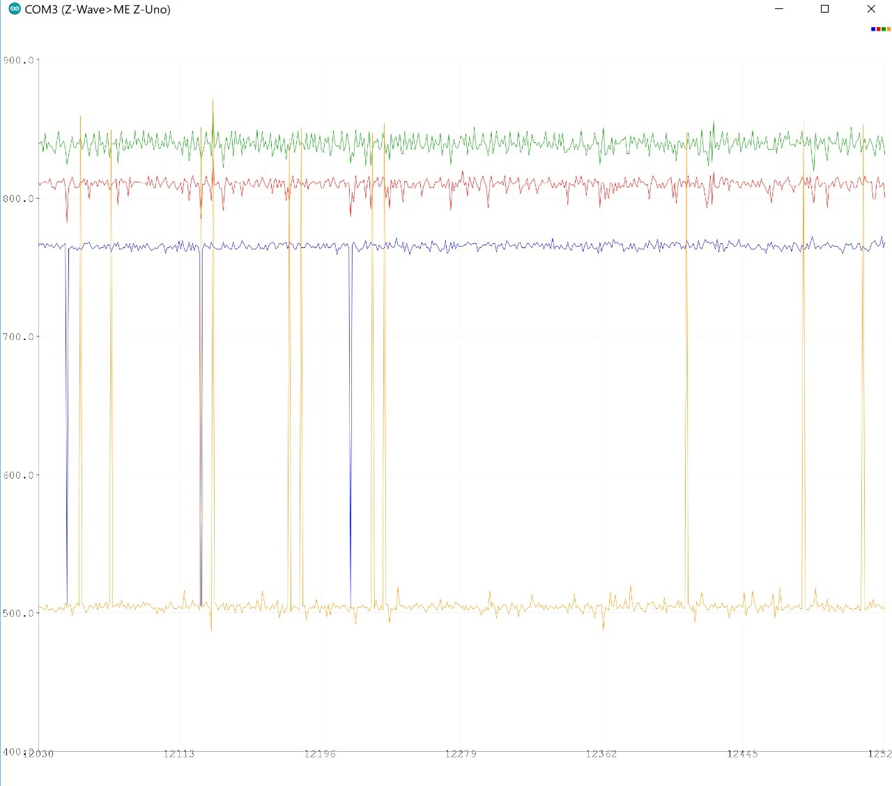

I have a simple set up. A3 channel of ADC is connected to ACS712 current sensor through voltage divider (to get maximum 3v instead of 5v).
No current is applied to ACS712 so it constantly outputs 1.5v. Other channels are not connected to anything.
I collect values to see them on plotter
* int a0= analogRead(A0);
  int a1= analogRead(A1);
  int a2= analogRead(A2);
  int a3= analogRead(A3);
  Serial.print(a0);
  Serial.print(" ");
  Serial.print (a1);
  Serial.print(" ");
  Serial.print (a2);
  Serial.print(" ");
  Serial.print(a3);
  Serial.println();
Resulting picture:
a0 blue
a1 red
a2 green
a3 yellow
I can not get:
1. Why A0 and A3 charts has quarter of the range spikes
2. Why levels of not connected channels are so different
2. Why a1 and a2 noise is so correlated

zunoADCAdvConfig(ZUNO_ADC_ADV_AZP1024); removed spikes so I got enough precision.
Actually I now calibrate ACS712 before start using it - constantly get samples within 500ms while there is no current and treat the average as zero while maximum deviation as threshold. So to get current value (AC) I collect samples within 500ms , calculate RMS and if it is greater then sqrt of maximum deviation obtained while calibrating it is returned otherwise current is treated to be 0.
