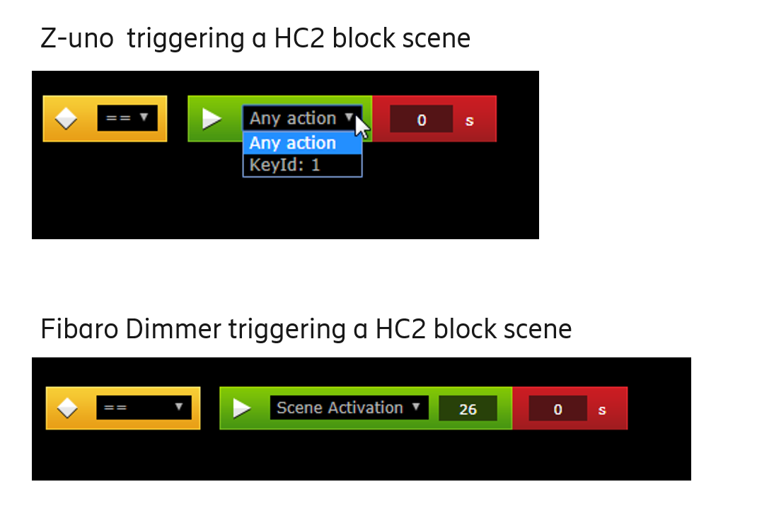

My zuno sketch defines 10 scenes (0-9) but when I try to program a block scene in HC2 there is only one scene-id to choose from. Actually, "Scene id" in zuno translates to "KeyId" in a HC2 block scene. And to confuse things even more, it is called "sceneActivation" in the LUA code. Not very logical if you ask me.
The strange thing is that it is scene 1 that appears in the list. Why not scene 0 which is the first one? And sometimes when I include the zuno I get all 10 scenes in the drop-down, from KeyId 0 to 9.
Compare this to another device I have (Fibaro Dimmer) which also sends scene commands. For this device however, there is no drop down with predefined scenes, I have to type in the scene number myself. In this example I am triggering the block scene when scene id 26 is sent from the dimmer.
