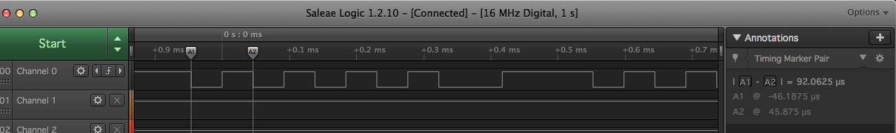

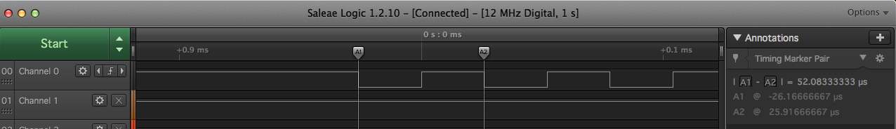

The amount of delay between each bit was determined through trial and error until I got the timing right. Now, here's the problem: when I power the z-uno with my laptop, the timing is all wrong. The z-uno seems to be running at ~50 % compared to when I use a charger. Here are some measurements I did with my oscilloscope. The first picture is when the z-uno is connected to a USB power supply (5 V, 2.5 A) and the second is when it's connected to my laptop.
Image Image
I did not re-program the z-uno between these capture. I only changed the power supply.
What is wrong?
