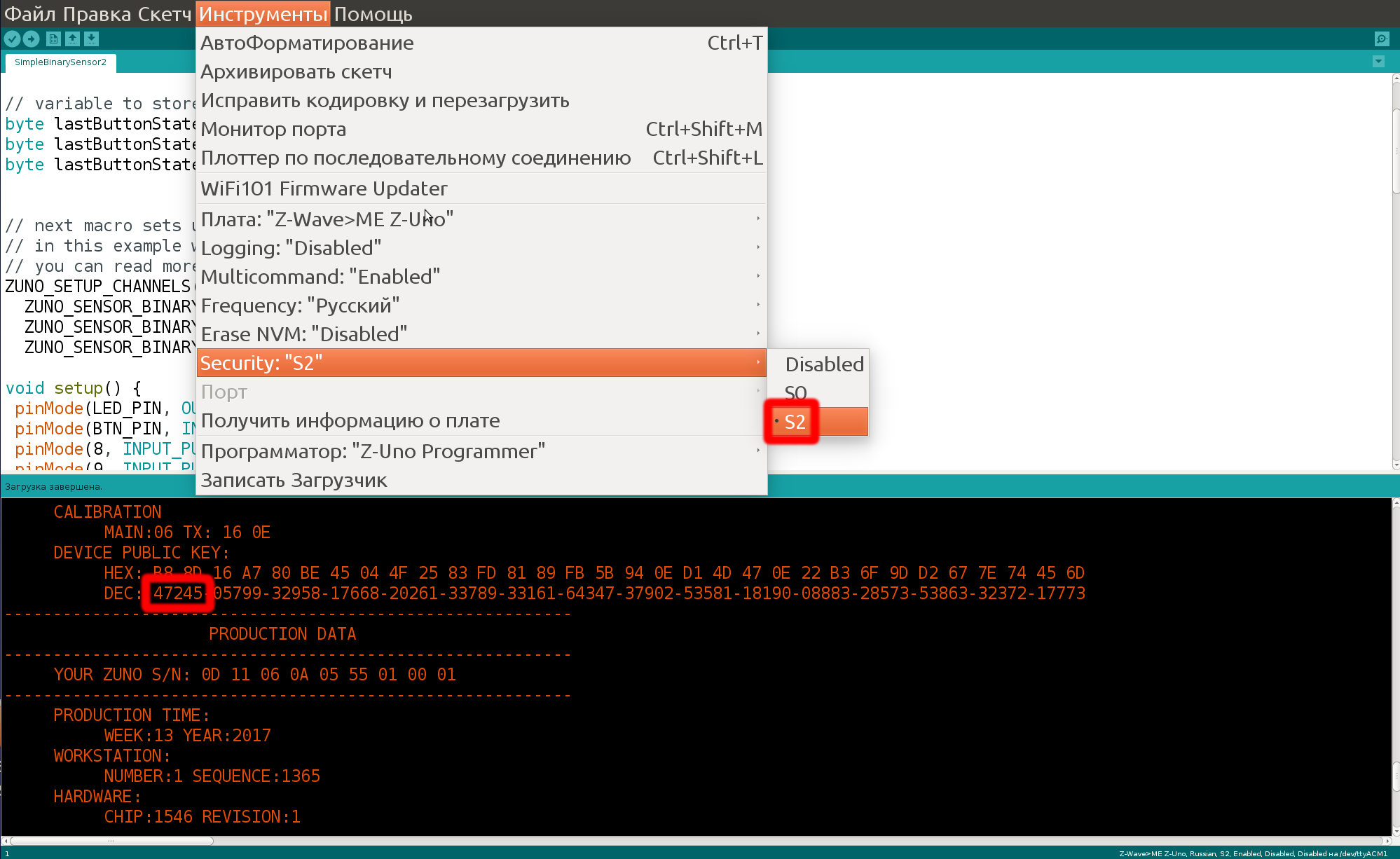

Notes on S2
  • To benefit from the newest Security S2 you need to have a modern S2 capable controller. RaZberry users can check the beta v3.0.0 release candidates.
  • You need to change the bootloader from non-secure/S0 to S2 version. This is done by selecting S2 from the menu Tools->Security (see the screenshot). Then do Tools->Burn bootloader.
  • To locate the Z-Uno PIN (also known as DSK or ZWS2DSK) check the log of the Arduino IDE (see the screenshot).
  • Z-Uno supports S2 Unauthenticated, S2 Authenticated and S2 Access.
  • Z-Uno can autodetect the security scheme used by the recepient, so it can control devices with any S2 security level provided the corresponding key is granted to Z-Uno.
  • Z-Uno with S2 support can not control/support S0 security scheme. If you need to control actuator with S0 security only, either downgrade to S0 your Z-Uno or use rules on the controller to receive S2 sensors notifications and send S0 commands to the S0 capable actuator.
  • In S2 variant of Z-Uno the user code is limited to 6 Kb only. This is enough for most of devices.
  • This is a not yet certified Z-Uno software - we plan to certify it soon in the Z-Wave Alliance.
