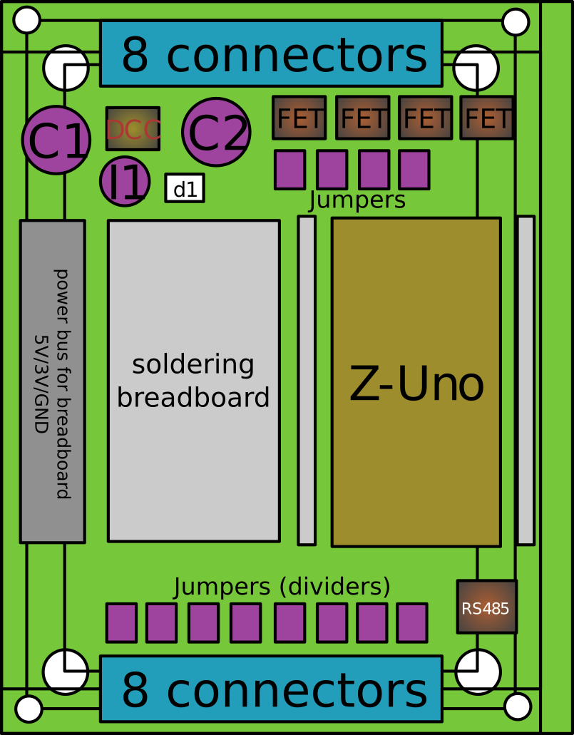

What do you think about a shield for Z-Uno that fits 4u DIN or IP44 cases by Gainta, have 4 FET driven PWM outputs for relay or RGBW LED control, 4 i/o with configurable voltage dividers for 5V or 12V, ADC, 1-wire, 2 fast pins, UART, built-in RS485 and additional soldering field?
It is already on the way!
If you have more ideas for this shield, please share!
Z-Uno Shield.png (122.98 KiB) Viewed 19982 times
In more details:
  • 3V, 5V or 12-24V input (for popular DIN-rail power supplies)
  • 4 PWM outputs with FETs to drive relays or RGBW (4 channels) LED strips
  • UART or RS485 (configurable with a jumper)
  • 4 ADC inputs with dividers for 3V, 5V or 12V (configurable with a jumper)
  • 2 fast pins
  • SPI and I2C available on soldering breadboard
  • all Z-Uno pins available on the soldering breadboard

RGBW = short circuit protected? With current measurement?
Re: Shield for Z-Uno
No power measurements. Just a MOSFET to drive a high current output. You can add the measurement chip yourself.
No protection - we just turn it on/off.
Why do you need protection if the wiring is correct?

True! I need it, when the wiring is incorrect ;)
Maybe the mosfet is so powerful, it can survive a short circuit and drag the supply down...?
If I would make my own RGBW I would use "Smart Low Side Power Switch" used in automotive. I have some older BSP78. Very robust.

Here is an updated list of features of the Z-Uno shield:
  • Energy efficient (switching) power supply for Z-Uno with 6-30 V input. Up to 500 mA output on 3.3 V to power your additional peripherals. Poplular DIN-rail 12 V and 24 V power supplies are perfectly ok.
    You can still power with 3V or 5V directly to Z-Uno.
  • Control of 4 channels switching with DC (up to 24 V, up to 10 A per channel or 15 A totally) switching. Implemeted as open collector (FET), can be used with Z-Uno PWM (analogWrite). Can control relays, RGBW LED-strips, electro-mechanical locks, valves, solenoids.
    Those channels can also be used to drive dimmers with 0-10 V control input (you need to do PWM of a 10 V power source - this will be seen by dimmers as 0-10 V input).
  • 2 connectors for UART 3.3 V or RS485 (embedded SN65176BDR) or GPIO (configurable with a jumper) - connected to UART0 pins. Can be used to read data from inductrial meters
  • 4 ADC inputs with dividers for 3 V, 5 V or 12 V or GPIO (configurable with a jumper). Connect sensors with voltage up to 13.7 V.
  • 2 fast pins for GPIO or OneWire
  • Free breadboard with 14x3 + 15x3 holes to place additional components of your choice. All Z-Uno pins available near the the breadboard. Use Z-Uno GPIO, UART, SPI, I2C or OneWire to connect your peripherals.

This shield looks great! I'm looking forward to buy one or two and fit them inside a DIN rail casing.
Is the shield available already, please?
Where can I order it?
Idea: I'd like to have voltage divider for 10V ADC input, as 0-10V is the standard for many industrial sensors. But 12V divider can be used for this too, sacrifying some portion of accuracy in favor of safety.
We hope to make the shield available in July. Our master distributor Z-Wave Europe is supposed to distribute it across all Z-Wave e-shops like Z-Uno.
The DIN rail housing will be included with the shield.
We made 12 V divider because it also fits 10 V input and is tolerant to 12 Volts too. Since Z-Uno have 12 bits ADC the accuracy should be still enough.

Hi guys, any progress with getting the shield on the market? I'm checking eshops every other day but still nothing...
Not yet. We are running production end of this month. I hope we can get it in the market end of August.
It will be in three casings:
DIN-rail variant in Gainta ​D4MG (http://www.gainta.com/en/d4mg.html)
Sealed enclosure (IP65) Gainta ​G2104C (http://www.gainta.com/en/g2104c.html)
Enclosure with flanges Gainta NUB1057035WH (http://www.gainta.com/en/nub1057035wh.html)
Will be equipped with a Z-Uno.
We also plan to make a code constructor to easily build code for most popular options. Those sketches will be compiled right on our site - no need to download the Arduino IDE - just checkbox items you need in your Shield and download the sketch for OTA or code for IDE. OTA is easy to use in Z-Way to upgrade user sketch without connecting to USB
