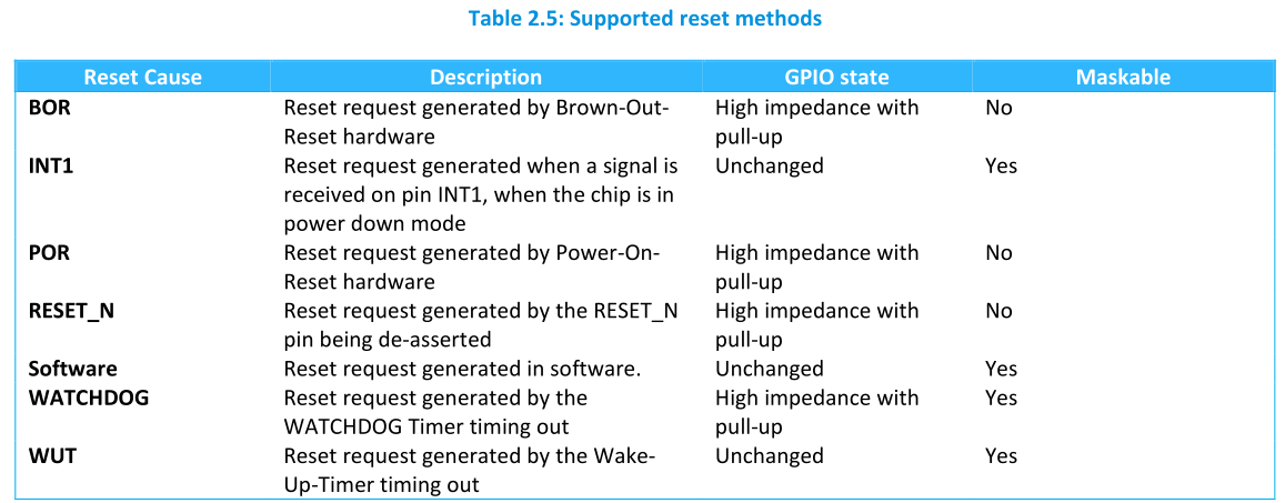

Quick update... A bit more detail in the ZM5202 datasheet... But this does not explain the "flapping"...
"Some reset methods deliberately leave the state of GPIO pins unchanged, while other GPIO pins are set to high impedance with an internal
pull-up."
pull-up."

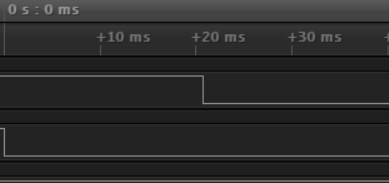

I'll do some more tests but here is a quick result, wake up tested on pin 9. I use the test sketch at the end of this post. To wake up the device, I pull INT1 to ground.
- When the Z-Uno goes to sleep, state is preserved.
- When the Z-Uno wakes up, the pin goes to weak pull-up mode after some time. I did a quick test and from triggering INT to pull-up was about 20 ms
- Then your setup routine runs, so it depends on where and when you set the pin state of the device... Then it goes back to the state you want. But there is always a short delay, so it will always "flap" as you call it.
For Example, In my test sketch, it takes 7 seconds before I drive the test pin high. There is a 1k resistor from pin 9 to GND, so this pulls the pin low even when there is a weak pull-up. This is the result on my logic analyzer:
Top = pin 9
Bottom = INT1 (wake up trigger)
EDIT: I am unable to attach 2 pictures... Oh. Well. You just see pin 9 is low for 7 seconds after wake up.
If I zoom in, you can see when the pin goes to pull-up after waking up:
Top = pin 9

petergebruers
- Posts: 255
- Joined: 26 Jul 2015 17:29
Re: FLiRS - flapping digital pins after wakeup
It is not you... wake up is tricky!
I see at least one issue... In setup, you have to read NZRAM and set the pins according to that. So, after the devices wakes up, first the pins "flap" as you said, but then in setup you set them to output and also on or off, as indicated by the NZRAM. In my sketch (see first post) you'll see I call function SetLed(); in setup(). It is defined as:
I solved it this way:
LoopCount10ms increments every 10 ms (timer interrupt) and WakeUpReason was determined in setup(). If wake up was because of radio transmission, I keep looping there for 1 second, then I do zunoSendDeviceToSleep(); So I delay the "going to sleep".
It might not be needed on 2.1.3... There might be simpler ways of doing that (I tried some, loke counting loop() iterations, but it was not as good as this solution).
I think that was the only way to make 2.1.1 behave correctly. If you do zunoSendDeviceToSleep(); immediatly, I got effects like you: bad status on controller, sometimes on/off did not work...
Then the second thing was an issue on older firmwares, I am not sure if it is still true... If you send the device to sleep immediately, the Z-Uno might do something wrong with communication. There is a post on this forum.// SetLed() reads NZRAM (last set by setter or setup)
