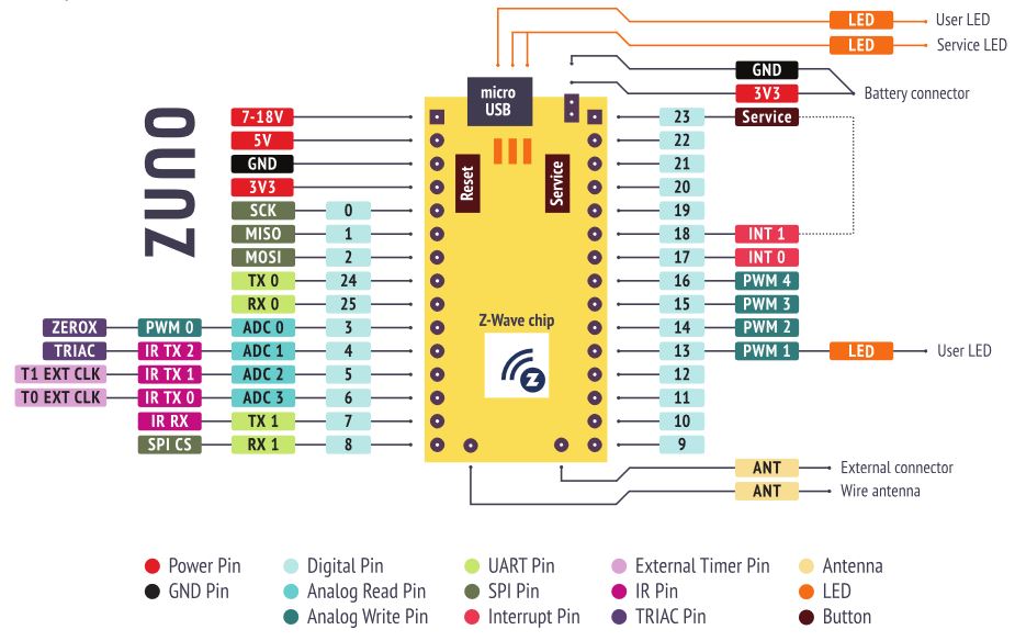

Serial pins are:
USB port for "Serial"
TX0 RX0 for "Serial0"
TX1 RX1 for "Serial1"
Z-Uno pinout.jpg (86.01 KiB) Viewed 14193 times

Basically, instead of SoftwareSerial, you can use pins TX0 + RX0 (+GND of course).
And then call the UART0 interface functions like this:
- Serial0.begin(9600);
- Serial0.print("Hello world");
BTW, if you are passing a message to ATTINY via serial interface, it's good to include some kind of "transmission control protocol". For example sending <CR><LF> at the very end of the message. ATTINY will check the receive buffer for that sequence in order to be sure that transmission is done and that a new transmission will start from scratch. Otherwise, when something bad occurs, you may want to send 1236 1237 but the ATTINY will process 3612 becease of that error.
Serial0.print("1236");
Serial0.print('\r'); //<CR> carriage return
Serial0.print('\n');//<LF> new line feed
While Serial0.println might also work for you, I prefer to add CRLF by myself.
