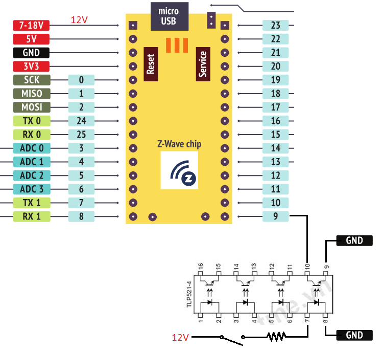

On the other hand, I have another problem bizarre when i plug an optocoupler like TLP521-4 on the pin 9 or 15 or 16 (other pin like 25 works).
It works perfectly until i make a digitalWrite Low on pin 10 for exemple. The pin 9 remains connected to the ground despite the pullup.
When I redo the same digitalWrite that works. And so on !
Here the schematic.
And the prog (sending "c" to cause the digitalWrite Low) :

I tested with version 2.1.3 and it's the same effect. And with a another z-uno. And with another TLP521-4.
Without optocoupler, it works fine.
It is as if the internal resistor was no longer connected when pin 10 is activated/deactivate.
I tested with addin a resistor pullup of 10k and it works.
I might have had to do another topic because it's not 2.1.4
Thank's.
Eric.

I have just realized that they are all those in a "s_pin".
Is there a relation ?
Eric.

Thank you for testing. Looks like you have found a very old issue with pullups. I have made only some tests and need a time.
Yes, they are on the same "port". P0 in terms of i8051.
I will report my results soon.

I have remarq that a pin 7,8 and 17 have the same problem with the resistor pullup.
It's not only the "s_pin" block.
Do you know if it is a problem hardware or software.
Need I to place a physical resistor pullup for each entry with optocoupler or you can resolv by program (please, please :P ).
