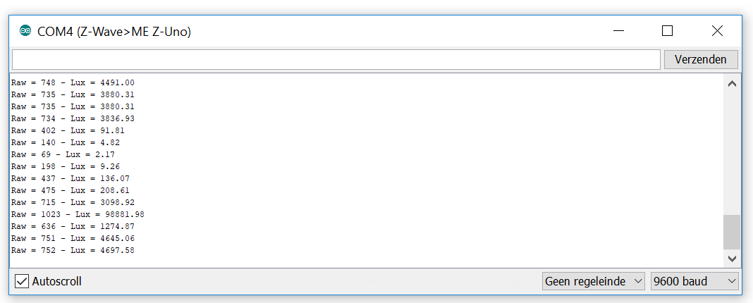

The electronics are working and are reporting the expected values in the serial monitor of the arduino IDE.
Serial monitor report.PNG (24.45 KiB) Viewed 7474 times

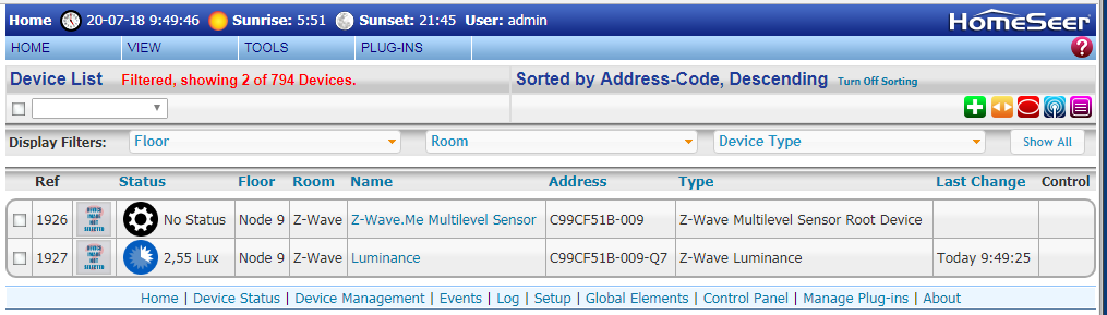

But I can't match the right datatype in HS3 for the device value.
The created device in HS3 when including the device into the z-wave network has apparently a 1 byte datatype.
Do I need to add something in the setup of the channel?
The device value is regulary refreshed but reports always 255 or 2,55(looks like it is overblown).
It looks like the Luminance device is always reporting it's max value of 255 (1byte).
How can I match the HS3 device value datatype to the one defined in the sketch (C# float (4bytes))?

Re: How to match device value data type in Homeseer?
Do not use float, but DWORD in your getter, because you use SENSOR_MULTILEVEL_SIZE_FOUR_BYTES

Re: How to match device value data type in Homeseer - SOLVED
Post by Jors Vandoren »
Thanks, the float was my mistake. All is working as intended.
