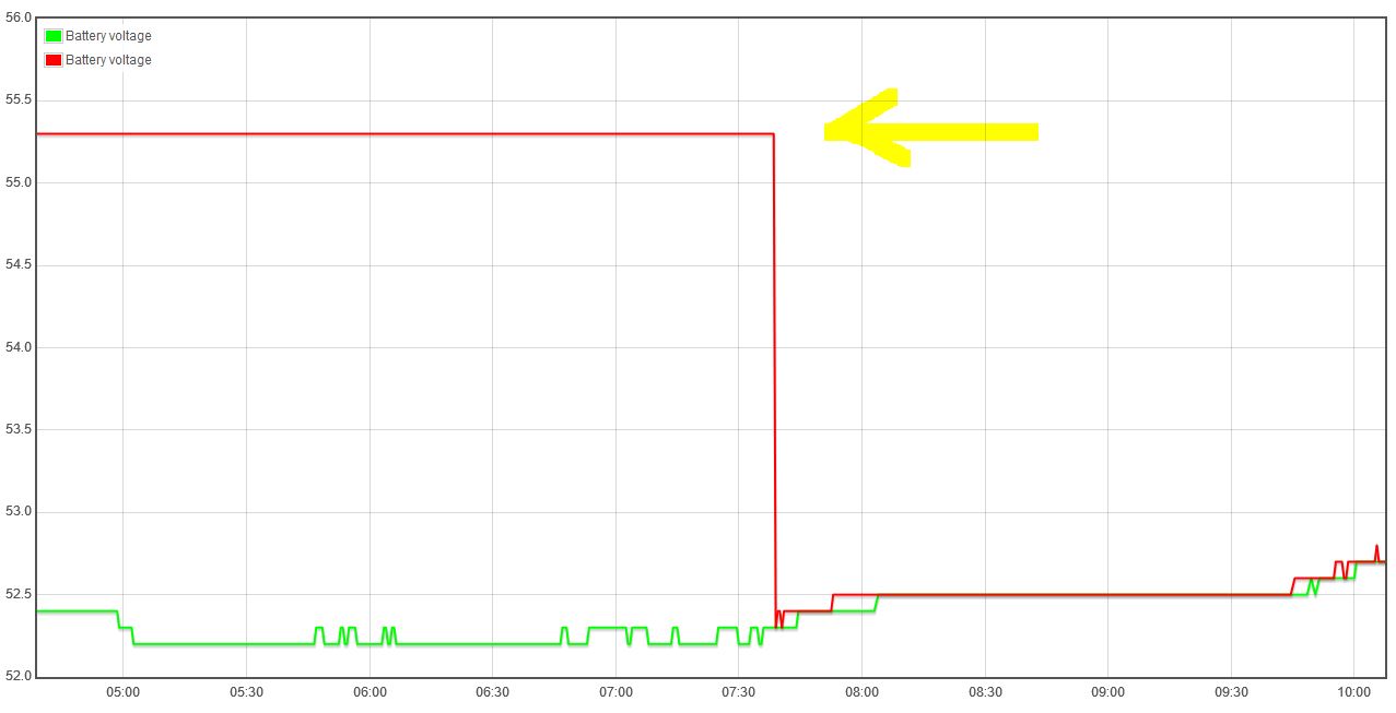

Hi guys,
I've experienced a strange problem with reporting values. This Z-Uno is reading the 7 electric values via a serial interface and once a minute it sends unsolicited reports to the Fibaro HC2. At the same time, Fibaro is polling every 13 seconds. Works great, but from time to time some of the values got stuck (or freeze) and a steady numeric value is being shown in HC2 for hours.
Here's the example: monitoring a battery voltage, the two values should be a very close to each other. But the RED value got stuck for hours, till 7:40, where it magically started to behave normally.
reported value frozen.JPG (66.25 KiB) Viewed 19830 times
I found that more channels I have, the higher is the probability of the described behavior. With 3 channels, it works flawlessly. With 7 it starts to behave like described. Also, found that if I send unsolicited reports in a different order, it might help a bit.
Can you help me, please? :shock:

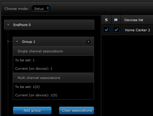

HC2 associations.png (11.85 KiB) Viewed 19829 times

  word getter7(){
    return VAL_BatteryVoltage;
michap
Posts: 443
Joined: 26 Mar 2013 10:35
Contact:
Re: Reported values got stuck sometimes
Post by michap »
the "freeze" of values - is it for same channels every time?
And - is it at any special time window? Maybe the connection to Z-Uno is bad while the freezing time? (any closed rollo shutter or something like this?)
Only a "stupid idea" ....;)
Michael
ondrej_bajer
Posts: 34
Joined: 17 May 2018 09:55
Post by ondrej_bajer »
Hi Michael,
channel 7 was freezing the most. But it was when I was trying to have 10+ channels. Then I removed some of the monitored values and went to 7 channels. Still, the channel 7 was freezing sometimes. So I reordered unsolicited reports so channel 7 is being sent the first. I'm convinced it helped a bit, but it might be a fake impression.
There's not a specific time window and I have no roller shutters installed :)
Maybe that I'm overloading the network with all the polling as I have another 5 devices (mix of Z-Uno's and Fibaro's) , each being polled number of timer per minute...
michap
Posts: 443
Contact:
Post by michap »
Try to send every 5 minutes an average value - and reduce the polling time - and check it .....
Michael
ondrej_bajer
Posts: 34
Hi guys,
I will walk through all my Z-Uno devices, extend intervals and remove zunoSendReport for all the channels except the 1st. Technically, I don't need zunoSendReport but I found that it helps HC2 to re-establish communication with a device after a power loss. In such a case, HC2 marks the device as Dead Node and stops polling it, zunoSendReport causes the device to appear active again. Therefore, sending a report for 1st channel should be sufficient. Am I right?
michap
Posts: 443
Contact:
Post by michap »
Why you need polling at all?
The sensor (Z-Uno) will send the values to the HC2 - this is enough, right? In best case the sensor will send values only if a value was changed, or after any defined time (for the case that not changes). This will optimize the network traffic.
Michael
ondrej_bajer
Posts: 34
The nice feature of polling is, that you can change intervals on the fly, directly from the Z-Wave controller. With unsolicited reports, you have to put min/max update intervals in the code itself, so the change is not so quick and easy. Second reason was, that polling all the channels at same time and then using the values for calculations (IE: power from Volts x Amps) appeared consistent to me. Sending report on value change was not looking as a best approach, as Volts & Amps are changing on every read, resulting in reports being sent repeatedly in the shortest allowed time.
Therefore I went for polling first.
Now, with a growing number of devices in the network, and with the issues I do experience, it looks like the well defined unsolicited reports generation will be a better approach. But there are two complications associated, that I have to solve:
- I don't want to loose granularity of the values. For example, I cannot send a report only when a voltage changes by more than X volts.
- I don't want to end-up sending values periodically in the shortest allowed interval.
So, how about to send unsolicited report when:
- change is bigger than X AND a shortest possible interval has passed
OR
- timeout from the last report has been reached
Timeout has to be counted from the last report on that channel, because this will introduce a sort for randomness (otherwise it will end up like all the channels sending updates in the same second).
Is it a good idea or not?
Thanks!
Ondrej
