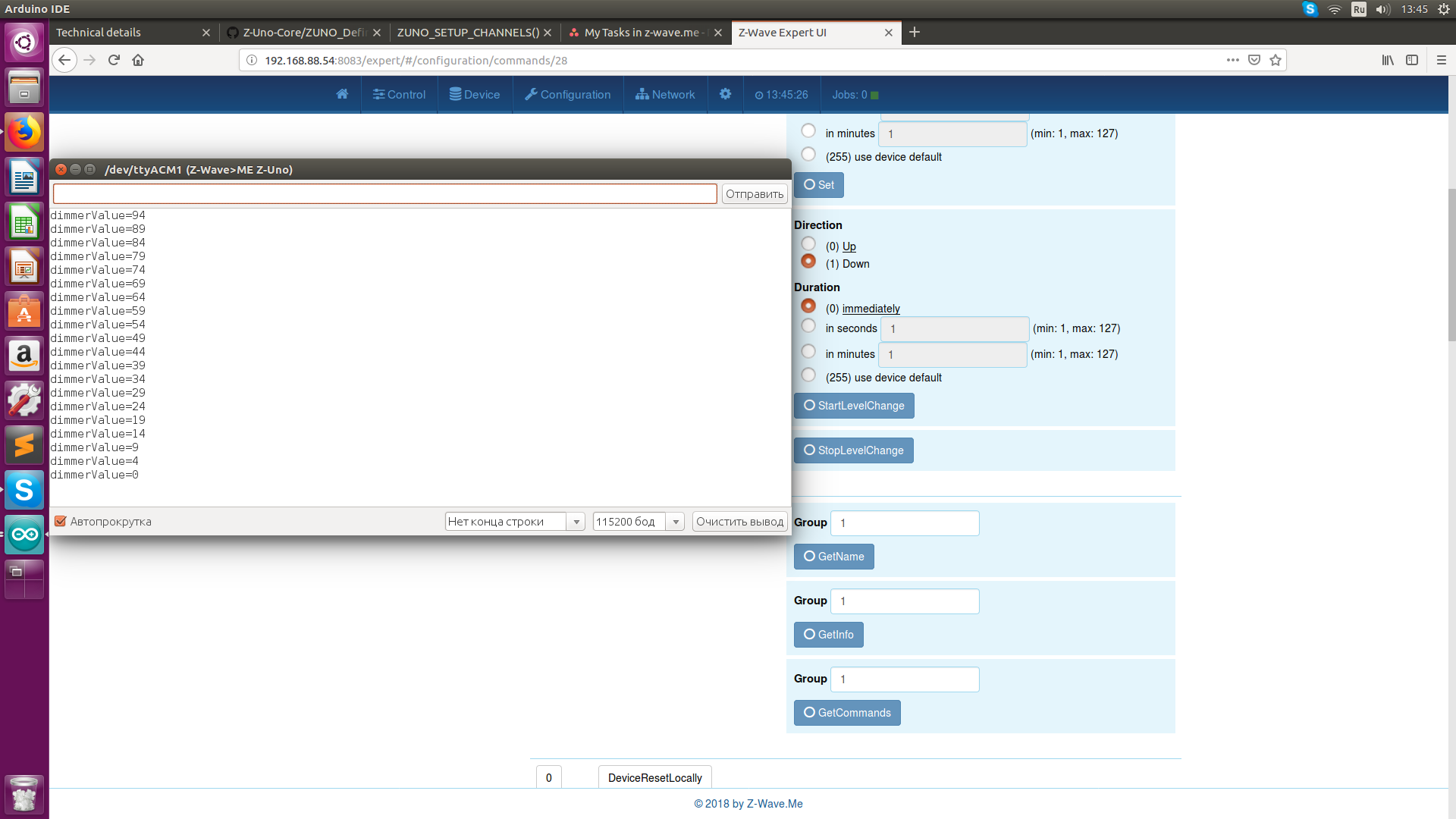

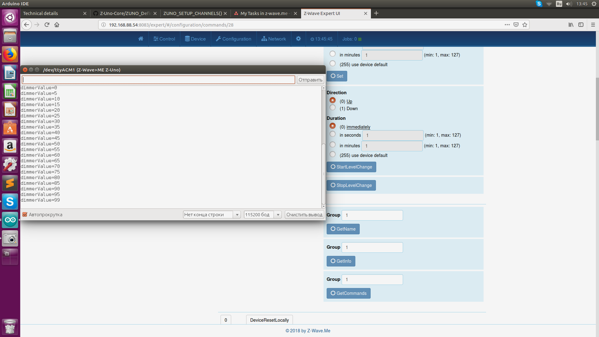

We have checked it with v 2.15 (the latest beta, with r2.14 it have to work too) it works ok. Please try this test-sketch. Screenshots & sketch attached.
Sketch (was refactored from RadioBklink example)

Hi p0lyg0n1,
yes, the blinds are working very well - this is not the problem.
Your test-sketch is ok too - but the stop option is not implemented in it.
How have you validated the fibaro stop functionality? Please push the e.g. down button and wait for some seconds - then push the stop button (marked in my first screenshot attached) - nothing happens - there is no setter called.
