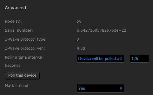

Everything works fine for a few hours. Then the connection is lost.
Anteckning 2019-03-27 111847.jpg (7.21 KiB) Viewed 8412 times
If I do something externally (like trigger a pin with a button) OR force communication with the 'X' i get comms again.
Anteckning 2019-03-27 111841.jpg (5.5 KiB) Viewed 8412 times
Polling is like this:
Anteckning 2019-03-27 111835.jpg (15.83 KiB) Viewed 8412 times
What am I doing wrong? Do i need to periodically send data from the Z-Uno with the sketch or can this be handled in some better way?

Re: Z-Uno and HC2 loses communication
Is your Z-Uno sleeping? It is better to use unsolicited reports from the device rather than poll it

I haven't changed any settings regarding sleep so default should be never sleeping.
Unsolicited reports; how do I do that? Where can I read about it?
Thanks :)
Edit: I noticed I shouldn't have multi command enabled with HC2, but I do. Would this give that symptom though?
I would suggest to first remove all features like Security and MultiCmd (in the IDE Tools menu) and check if the problem persists.
Read about zunoSendReport for unsolicited reports
