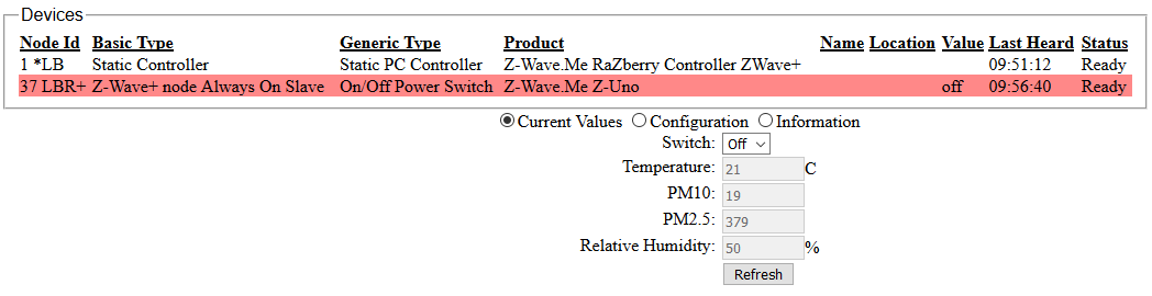

Using the OpenZWave control panel of Domoticz I can see all values, with quick update when refreshed (the switch is just for testing):

So far only the Temperature & Relative Humidity are visible and correctly updated as Domoticz devices :
I have read in several threads about the missing support of Multichannel sensors in Domoticz, however I think there is a way to modify the existing ZUno.xml description file to make the missing channels appear as devices in Domoticz, do you think it is possible ?
If not, what alternative method could I use to get the values of the 4 channels ? I was thinking about the OpenZWave JSON API maybe ?
For information under Jeedom and Z-Way servers (which are (*) Jeedom seems to be also using OpenZWave) all channels are visible and usable normally.
