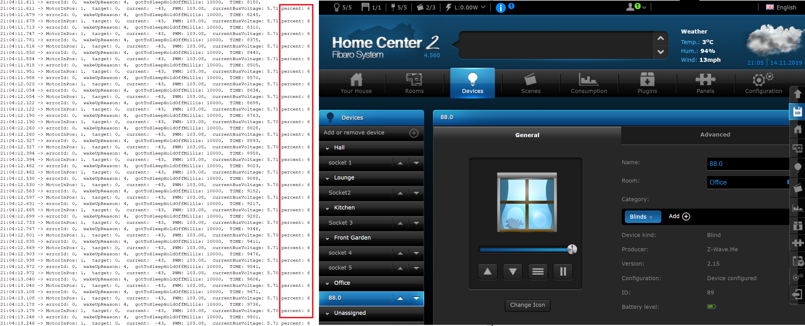

Ive swapped the code back to the one that reports the battery percentage in the range of 0 to 100 and varied the bench supply before report 1 is sent (the sketch just has one control of:

So you can see in the screen shot the current buss voltage was at 5.70v resulting in a reported 6% battery value, but fibaro is not showing that. The only time fibaro seems to correctly show it, is if i unpair and re include the device.

and fibaro still report the same value as when it was originally paired. The little scroll bar displaying the blind position correctly updates if it alter the blinds position using physical buttons attached to the zuno so reports must be beeing sent to the controller, and its defiantly in FLIRS as all the LEDs go out and it only wakes up on the BEAM time out or zunoSetWUOptions(ZUNO_WUPFLAGS_INT1_HIGH)
Battery report.png (707.38 KiB) Viewed 19543 times
Any ideas?

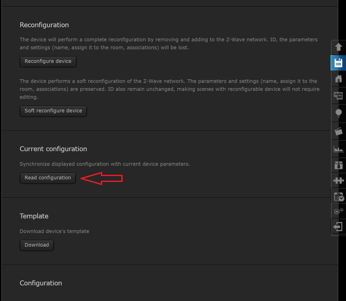

Hi, i would really like to thank you for all your help with this. It looks like you hit the nail on the head.
If it is the case it seems crazy that a flirs device (one would assume its made as a flirs device to conserve power ie battery powered) that battery reports would not be key in the day to day process of the device.
with regards to doing a HC2 test, i dropped the power on my bench supply and clicked the "Read configuration" button and when the screen refreshed i got a low battery, i then upped the supply back to full and did the same and the voltage went back up.
So i think this helps prove what you said. Thing to work on now is a way to automate hc2 to do a "Read configuration" on each of my blinds if i get this project dialed in say once every 24 hours.
