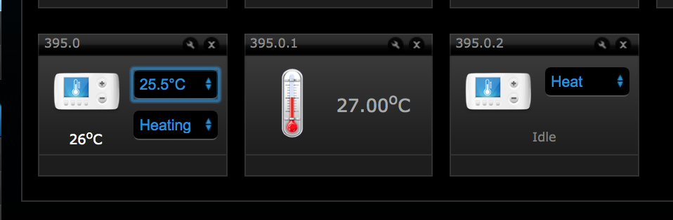

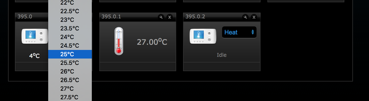

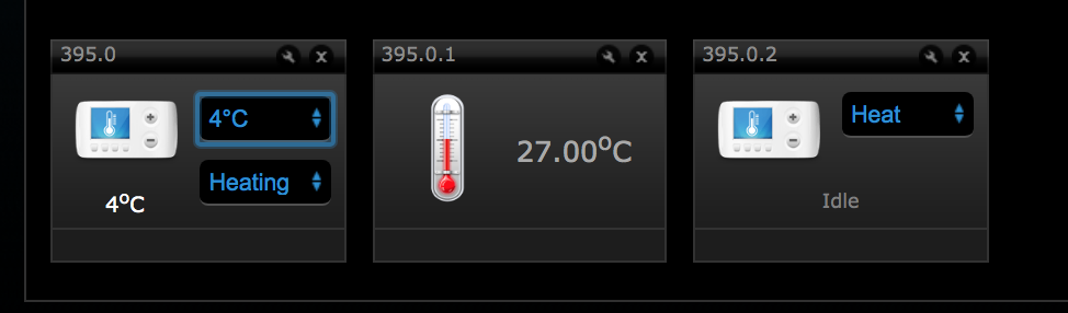

I've uploaded simple thermostate code created with Z-uno shield and on Fibaro HC2 I can't set the setpoint for example 25 or 26 or 27, as it goes back to initial 4C. If I choose 25.5 or 26.6 and so on - everything works fine.

Just checked on other controllers:
Vera working fine.
Home assistant initially working only mode, but after trial to change xml file, set point works with errors. Some numbers are working as 28.5C, but below 25 - result in hundreds C or even negative.
