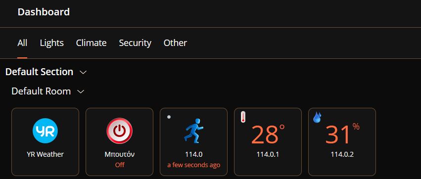

Hello, I use z-uno with Home Center 3 controller. I add 1 general purpose sensor, 1 motion sensor 2 door-window sensors and 1 dht11 sensor. The device added to my z-wave network but only the general purpose sensor of binary sensors and the dht11 apears in HC3.
This happens with every binary sensor I add. The home center 3 will show only the first binary sensor. Could you please help me to resolve this issue?
Attached: HC3 screenshot

Not all devices of Z-Uno appear in HC3
- hc3-pic.JPG (36.47 KiB) Viewed 7555 times
Re: Not all devices of Z-Uno appear in HC3
This is an issue in HC3 - Fibaro have to make a template. You can write them in support - this will certainly rise up the issue in their system

I have the same problem. Occasionally all the devices show up, most generally only one of them (and not always the 1st one). If you go into the Diagnostics -> Z-Wave, does your device show up in the devices without template section? If so, if you download the device data is your manufacturer ID also 0? Mine has this:
<zwaveData><basicClass>04</basicClass><manufacturerID>0000</manufacturerID><productType>0000</productType><productID>0000</productID>...
From the Z-Uno site: "ManufacturerId (0x0115) and a fixed ProductType/ProductId 0x0110/0x0001"
I was wondering if my device is not working correctly?
