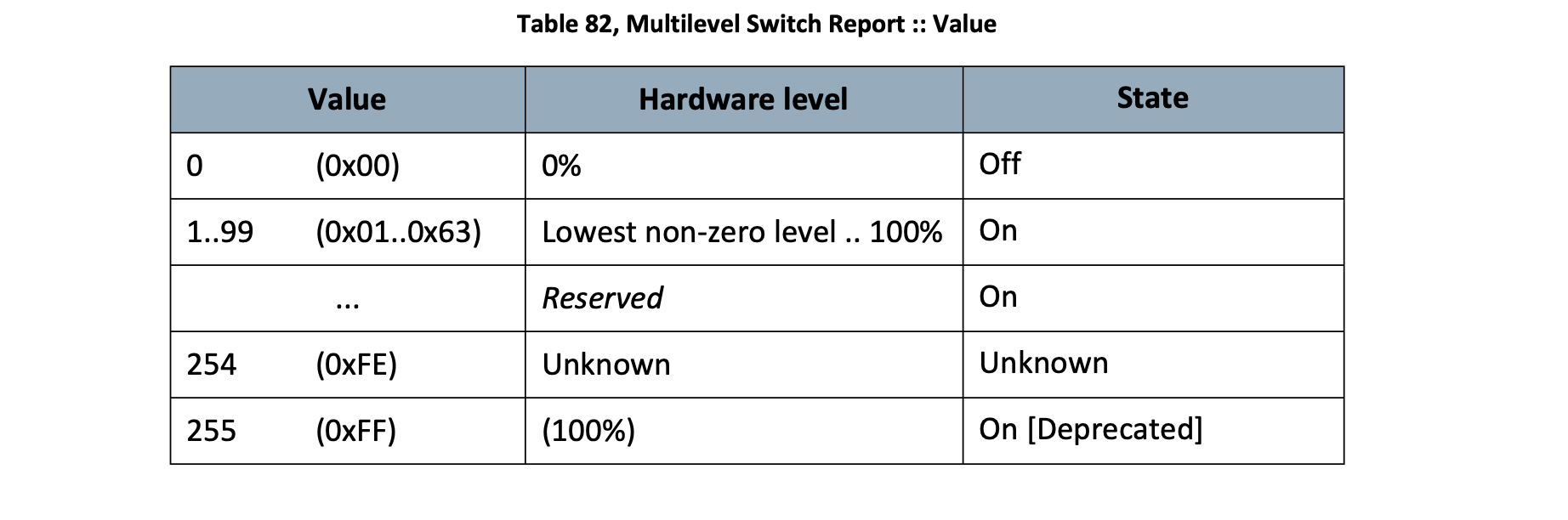

Indeed.... Please check this line in ZWSupport.ucxt
https://github.com/Z-Wave-Me/Z-Uno-Core ... .ucxt#L434
You can remove the check for 0xFF and then 0xFF will be passed as it is to the Setter. The file in the library folder.
The reason for this is because 0xFF was deprecated:
Switch Multilevel specification
Снимок экрана 2021-05-24 в 13.34.53.png (91.48 KiB) Viewed 17002 times

BTW,
the 0xFF value has been deprecated only for the Multilevel Switch Report Command, but not for the Multilevel Switch Set Command. This means a device must be able to respond to 0xFF values in Set commands, but should not report a 0xFF value when reporting back to Controller or other associated nodes.
