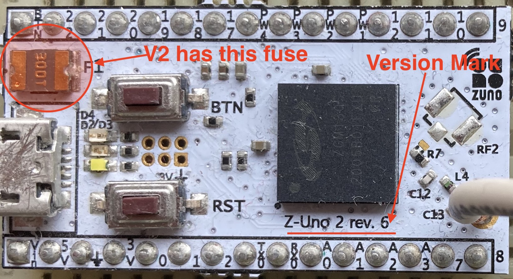

You can easily determine which board you have using the following methods
1. Look at the upper left edge of the board (see the picture) - if there is a fuse on it, you have the 2nd version.
2. Under the SiLabs chip on the 2nd version there is a marking ZUno 2 rev. 6 (see picture)
3. The latest version (2.18) detects connections of the 2nd generation board to the development tools for the 1st.
