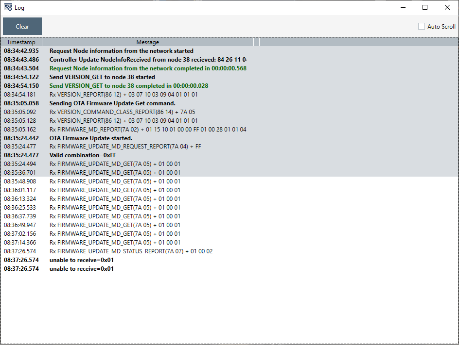

I have set config parameter 20 to 1 ready for OTA. When I execute the Update command for Target 1 the process repeatedly attempts to send packet 1 of 264. This is unsuccessful and the update does not proceed (I have tried the .hex file with the same problem). I've attached the log file. I have previously updated other devices, e.g. Heltun using this hardware and software.

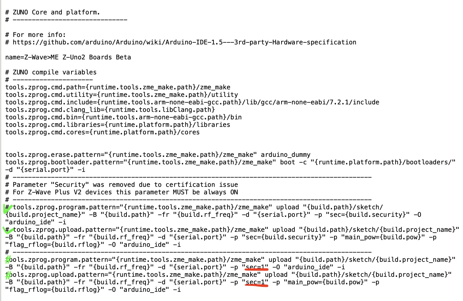

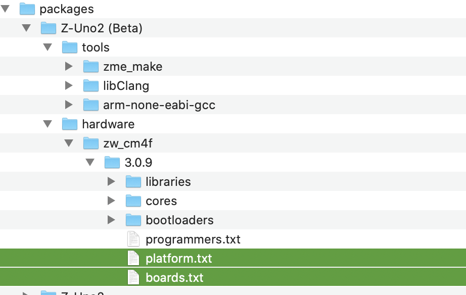

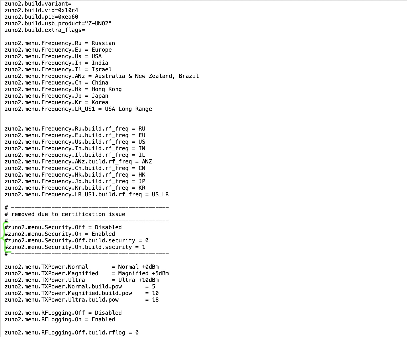

Hello. You can go back to the old option with the security settings in the IDE "at your own risk". To do this, go to the folder where the additional Arduino IDE packages are stored (use the hyperlink to the configuration file in the settings dialog). Open the "packages" folder and navigate to the files boards.txt and platform.txt (see screenshot). To get the setting back, uncomment the lines with a green check mark in the file platform.txt and add the comment symbol "#" before the lines in which it is specified. Uncomment the lines in the file boards.txt which are united by a green curly brace in the screenshot. You can also set always off for encryption by specifying "sec=0" in places that are underlined in red instead of returning the setting. Restart the IDE. You will be able to select the encryption mode again. After each update to the new version, you will have to edit the files.Good luck.
