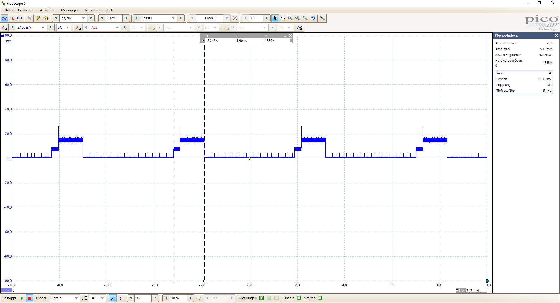

I want to send sensor data shortly and go to sleep after that for 5 sec. I want that the minimum of power is used. I thought the transmission time is just some milliseconds.
Unfortunately I measured that the z-uno 2 needs 1sec for transmission time and Z-Wave operation. Only 4 sec is the device in sleep mode.
The Z-Uno 2 is peered with an Z Wave Controller (Aeotec).
Attached you can see the timing diagram of the Z Uno 2 device current. It is measured with an oscilloscope and a 1Ohm resister.

How can the transmission time and Z-Wave operating time reduced to about 50ms?
Sleep Current.png (85.15 KiB) Viewed 10236 times

I'm checking it with the R&D, but looks the doc is wrong. zunoIsSleepLocked should return true when it is not possible to sleep (before zunoSendDeviceToSleep was called).

Could you talk R&D, could they find out why the transmittion time / CPU active time so long is? Please let me know. Is there anyway to reduce power consumption? Thanks
