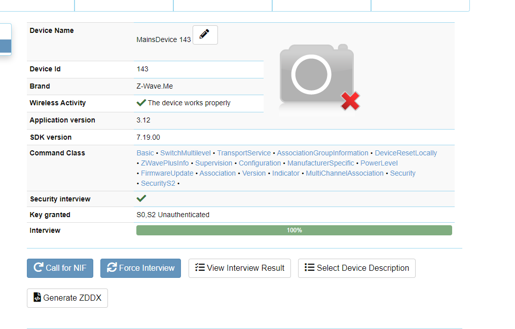

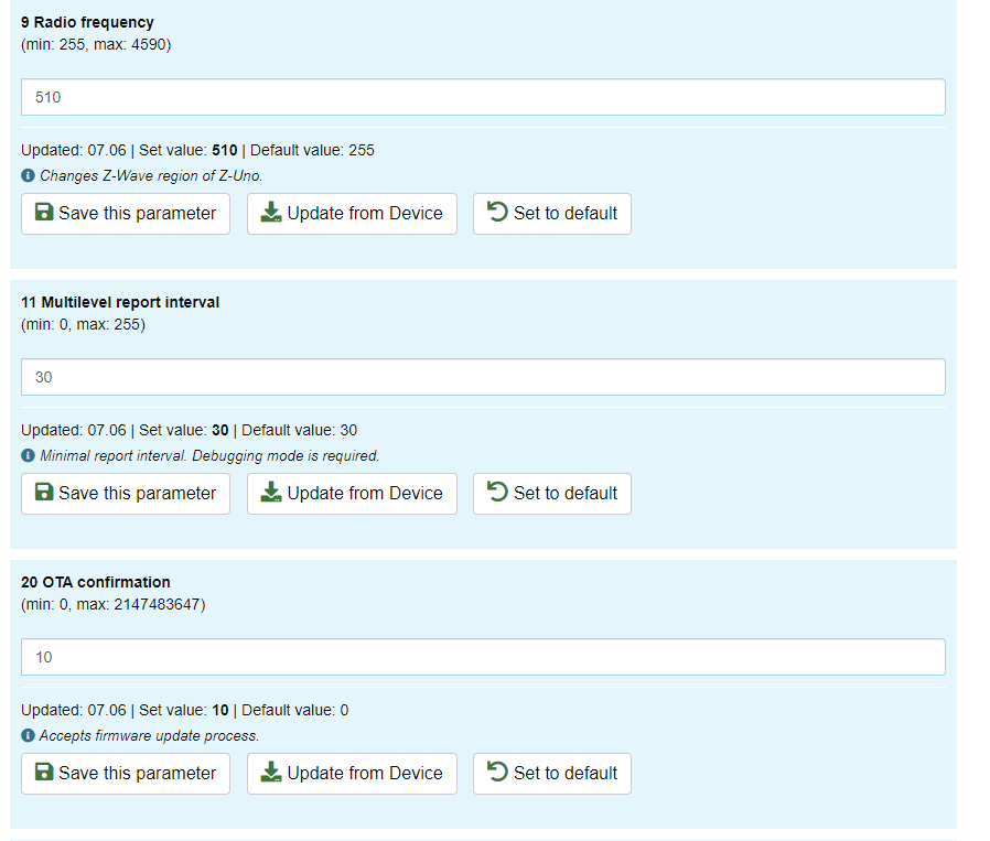

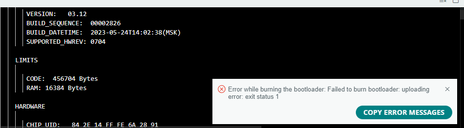

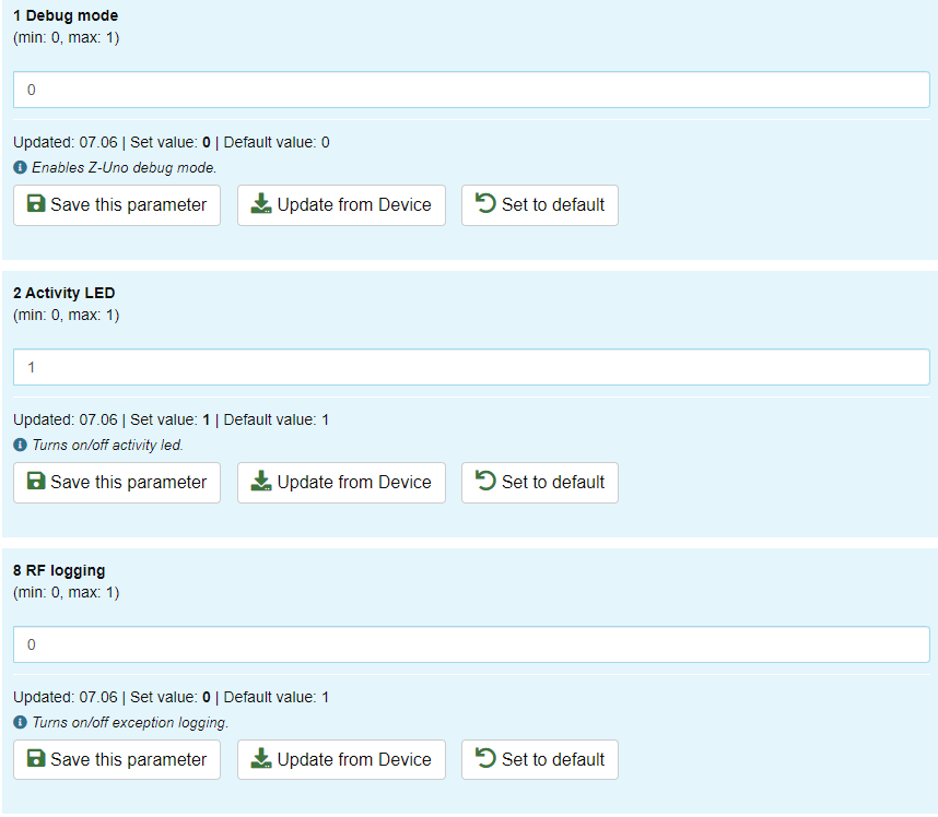

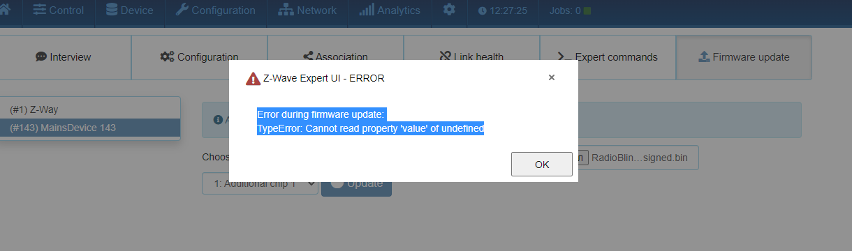

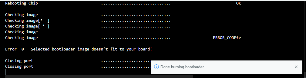

I tried to OTA upgrade my firmware on ZUNO 2 rev 6, first of all I burned the bootloader via Arduino-IDE, choosing Z-UNO 2 beta board, but there I got an interesting fact: Arduino IDE popped a window that the bootloader was burnt successfuly, but in the log file I found a record that the bootloader image doesnt fit my board. I tried all possible variations but the bootloader wasnt burnt anyway. Then I decided to try OTA upgrade the firmware with a binary file with a path from log file of the firmware compilation and when I uploaded the firmware to OTA upgrade page in Zway I got a message "Error during firmware update: TypeError: Cannot read property 'value' of undefined". Then I tried an OTA bootloader upgrade and it started the process, but then stopped at 37%. I was watching job logs and saw that during the communication between the ZUNO board and my RaZberry everything went ok, but suddenly the job log cleared and the process terminated (hang on forever)
Screenshots are attached. Please help me to resolve this issue

Hello! This is a Z-Way issue. Here is the fix: https://github.com/Z-Wave-Me/home-autom ... 6a343406ce
