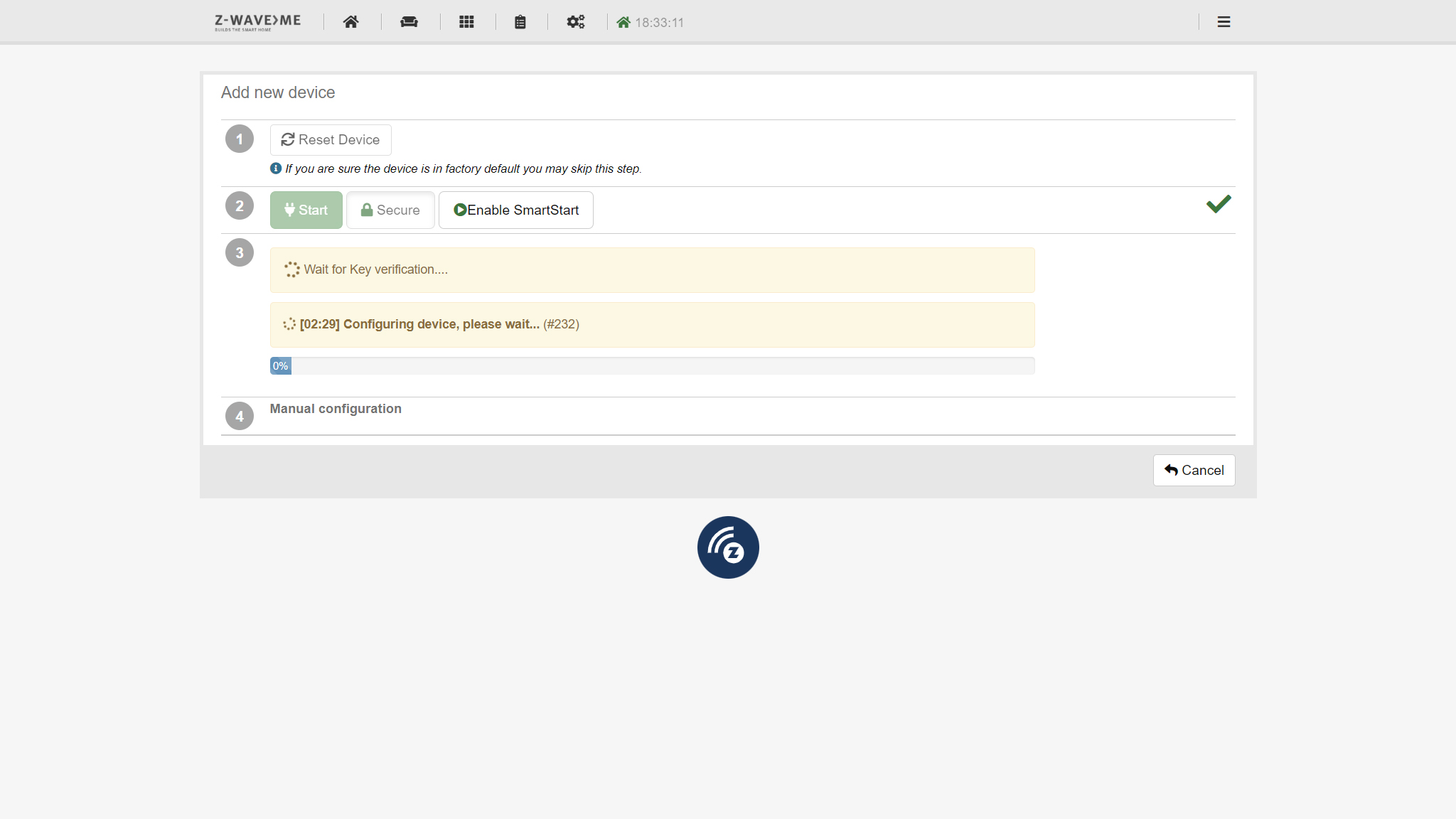

I updated the z-uno beta firmware in the IDE to 3.0.13. I uploaded the bootloader to board X and then the compiled sketch. After that I was unable to include the board to the network. Instead of information "Wait for Key verification".

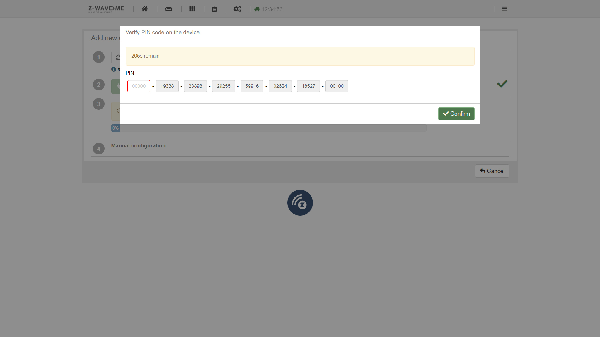

I get a request for a PIN

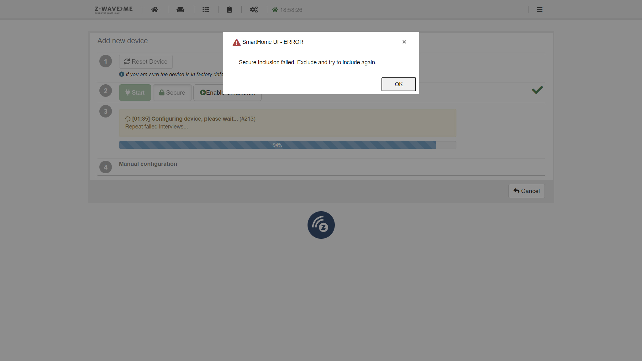

or "Secure inclusion failed".
Bez nazwy-4.jpg (185.38 KiB) Viewed 97816 times

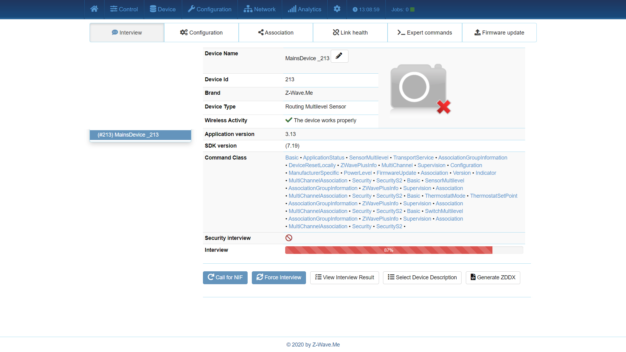

On the interview page you can see that the include is incorrect.
Bez nazwy-2.jpg (560.97 KiB) Viewed 97816 times

I have already tried to enter the same PIN and it is not possible. That is why I thought it was a mistake that it asks for the PIN. Thanks for the link but this PIN can also be seen when uploading a sketch from Arduino IDE to Z-Uno and running the Utilities->BoardInfo tool in VisualStudioCode IDE. A window pops up with a place to enter the PIN. After entering a number in this place, it is deleted every time. To make it more fun, another window appears with the information "authentication failed" which can also be closed indefinitely. The behavior is identical in browsers: Chrome, Firefox, MS Edge. I invite you to watch how I try to include z-uno to the network: https://drive.google.com/file/d/1CgIFKv ... Wcovo/view
