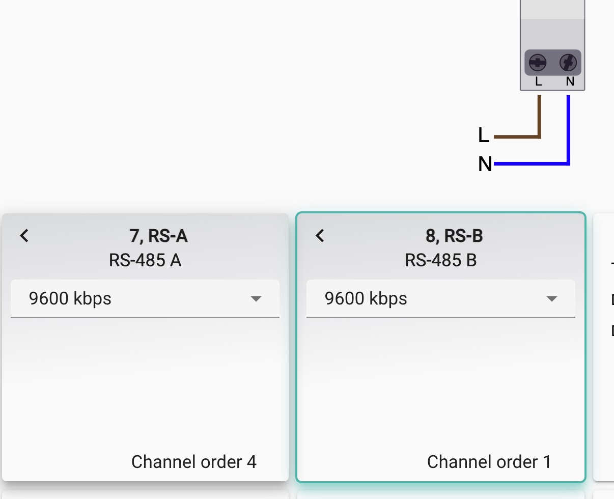

I am trying to makde and install a sketch for a flowmeter that communicate with RS-485.
Are using the new configurator and select like this picture con1.jpg (attached)
I get the SKECTH below.

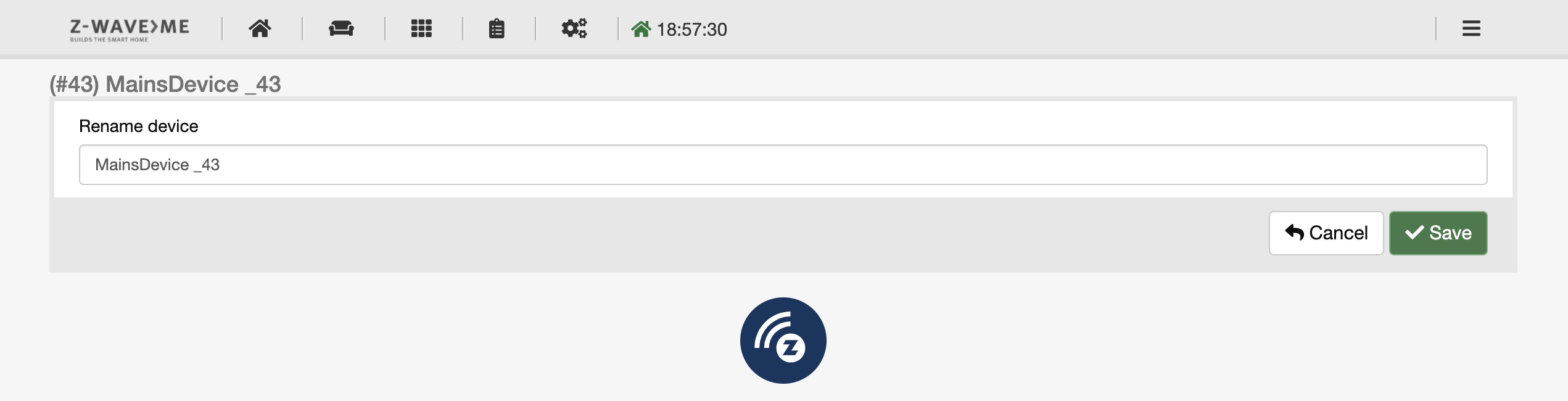

Then I pair the Z-UNO 2 board with my Z-WAY system version v4.0.3
The pairing of the device is successful. But the device show no measurements, see enclosed file device.jpg.

Re: Z-UNO 2 RS-485
Hello!
The RS-485 is just a physical layer. You should fill the RS-485 logic using writeRS485 and readRS485 functions and a channel (check the documentation how to add a channel or use the configurator and then decouple it from the pin (remove digitalRead or whatever is added)
