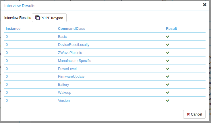

I don't know how often I have excluded and included again this device. Always it was the same: interview was completed, but only 9 command classes are displayed in interview results (always the same ones). According to the device documentation 18 command classes are supported.
Now after one more inclusion suddenly it shows 17 command classes including Alarm and Central Scene. Only command class Door Lock is missing. It's very mysterious.
Do you know whether this missing command class is disposable? Is anybody running the Popp Keypad with or without the Door Lock command class?

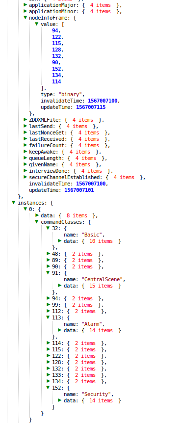

The NIF now includes 9 command classes. They are identically with the 9 classes from my previous trials, minus Basic plus Security. Security was missing in the wrong interview results.
I'm wondering why ZWay told, that interview was completed for 100%. And I'm wondering why NIF only contains 9 classes whereas the interview results now contain 17.
current classes
current classes
Bildschirmfoto vom 2019-08-28 19-26-52.png (40.82 KiB) Viewed 14895 times
previous trial
previous trial
Bildschirmfoto vom 2019-08-27 15-45-26.png (27.83 KiB) Viewed 14895 times
