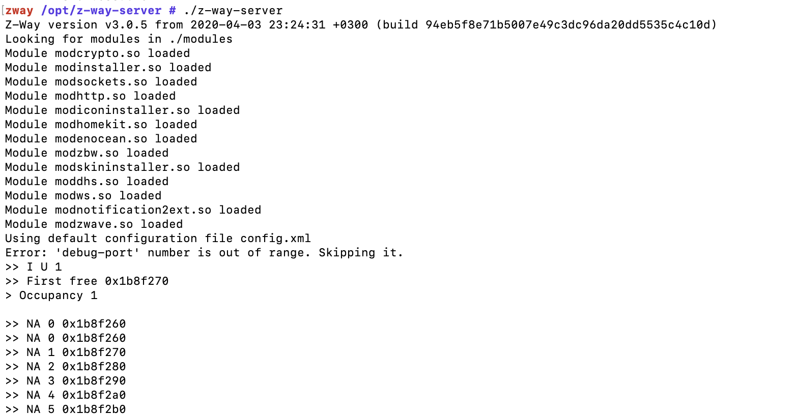

I've upgraded to 3.0.5, could it be it was compiled with some debug options enabled still?
As it seems to run really slow, and shows the following output:
screenshot
screenshot
Screenshot 2020-04-08 at 16.49.08.png (148.95 KiB) Viewed 7514 times
Or do I have a configuration parameter set I shouldnt' have?

Will a non debug version of it be released?
on the ubuntu version I am also seeing this output a couple of days after the installation:
Apr 10 18:18:22 ubuntu z-way-server[4822]: SSL DEBUG LOCK: 19 > 1
Apr 10 18:18:22 ubuntu z-way-server[4822]: SSL DEBUG LOCK: 19 > 0
Apr 10 18:18:22 ubuntu z-way-server[4822]: SSL DEBUG LOCK: 18 > 0
Apr 10 18:18:22 ubuntu z-way-server[4822]: SSL DEBUG LOCK: 18 > 1
Posts: 7649
Re: Errors after clean installation (Timezone, database update and send mail support)
This debug log is only on RPi. On Ubuntu it is not present. Those you see are from your openssl library
