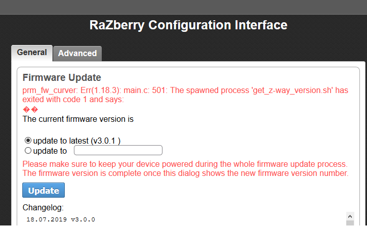

enbemokel
Posts: 499
Joined: 08 Aug 2016 17:36
Re: suggested Update to 3.0.1 fails, Z-Way installation corrupt!
Post by enbemokel »
Same here. Stretch, but also an error message.
Neue Bitmap.png (32.24 KiB) Viewed 8150 times
This will be fixed in next version on upgrade to 3.0.2
