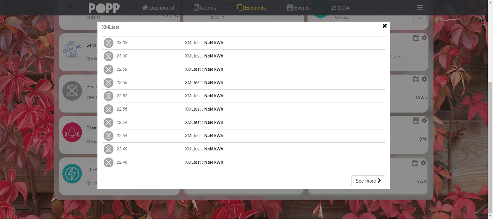

A few days ago, I did encounter a problem with this module. The values assigned to this virtual device, probably is of type:string. I found out because the userModule Arithmetic could not deal with the value. That worked after I added parseFloat to the code (not yet on github)
So I guess the module should at least have the options to deliver the retrieved XML element as:
type:float
type:int
type:text
Unfortunately the Z-Way API does not list a DeviceType in which I can store text. Float and Int types can quite well fit in sensorMultilevel, but text is appropriate.
How do I solve this? Can I use DeviceType text, just as in the new InfoWidget module? Is DeviceType:text now formally part of your apiary.io, and recognised by the HA engine?

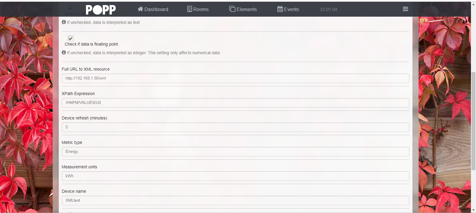

It would be good to add a checkbox in options to select between numeric (float/int) and text values and change deviceType accordingly. text like in InfoWidget is perfect.

There is a new release on Github (see link in first post) that uses PoltoS' suggestion.
Worked for me as text and numerical nodes. The later both with float/integer conversions.
