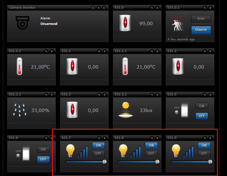

Hi!
is there any chance use Fibaro App https://www.youtube.com/watch?v=Wyz3alzhMgY with Z-UNO?
now Z-UNO RGB "controller" present as 3 (three) dimers/sliders
thank you!

Hi. I am wondering the same thing.
Is it possible to make the Z-UNO to appear as a RGBW device in Domoticz?
It’s not very convenient to implement 3 dimmers and control the RGB colors that way.
Re: RGBW LED strip + Fibaro HC2
Z-Uno will have RGBW channel in future. Currently only as N dimmers only ;(

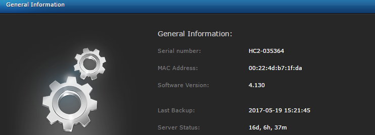

Fibaro recently released firmware version 4.130 and it appears to support the color switch class, although there was no official announcement.
It was discover by a user, after (re-)including a ZW range extender.
See:
https://forum.fibaro.com/index.php?/top ... controller
10der
Posts: 80
Joined: 08 Jul 2016 00:23
Location: Ukraine - Berkeley, CA
Post by 10der »
ho! ho! ho! nice try!
[21:55:02] Home Center in learning mode
[21:55:07] Device added
[21:55:16] Add node status protocol done
[21:55:16] Adding devices complete
[21:55:21] ID 531: Set association for group 1
[21:55:21] ID 531: Received association report from group 1
[21:55:22] ID 531: Received association report from group 2
[21:55:22] ID 531: Received association report from group 1
[21:55:23] ID 531: Set association for group 1
[21:55:23] ID 531: Received association report from group 1
[21:55:23] ID 531: Received association report from group 2
[21:55:35] ID 531: Device configuration finished
[21:55:39] ID 531: Device configuration finished
[21:55:41] ID 531: Device configuration finished
[21:55:42] ID 531: Device configuration finished
[21:55:45] ID 531: Device configuration finished
[21:55:48] ID 531: Device configuration finished
[21:55:50] ID 531: Device configuration finished
[21:55:52] ID 531: Device configuration finished
[21:55:55] ID 531: Device configuration finished
[21:55:58] ID 531: Device configuration finished
10der
Posts: 80
Post by 10der »
stop!
is it right declaration here?
, ZUNO_SWITCH_MULTILEVEL(getRed, setRed) //7
, ZUNO_SWITCH_MULTILEVEL(getGreen, setGreen) //8
, ZUNO_SWITCH_MULTILEVEL(getBlue, setBlue) //9
10der
Posts: 80
Post by 10der »
oops!
we still not support color class :(
C:\Users\olegd\AppData\Roaming\Arduino15\packages\Z-Uno>grep -r -i "color" *
hardware/zw8051/2.0.9/cores/zuno/ZUNO_Definitions.h://TODO #define ZUNO_ASSOCIATION_GROUP_COLOR_CONTROL
hardware/zw8051/2.0.9/libraries/ZUNO_MCP23017/keywords.txt:# Syntax Coloring Map for MCP23017
Binary file tools/zuno_toolchain/00.08.31/zuno_toolchain/libclang.dll matches
Binary file tools/zuno_toolchain/00.08.31/zuno_toolchain/sdcc/bin/sdcc.exe matches
Color is not yet supported
