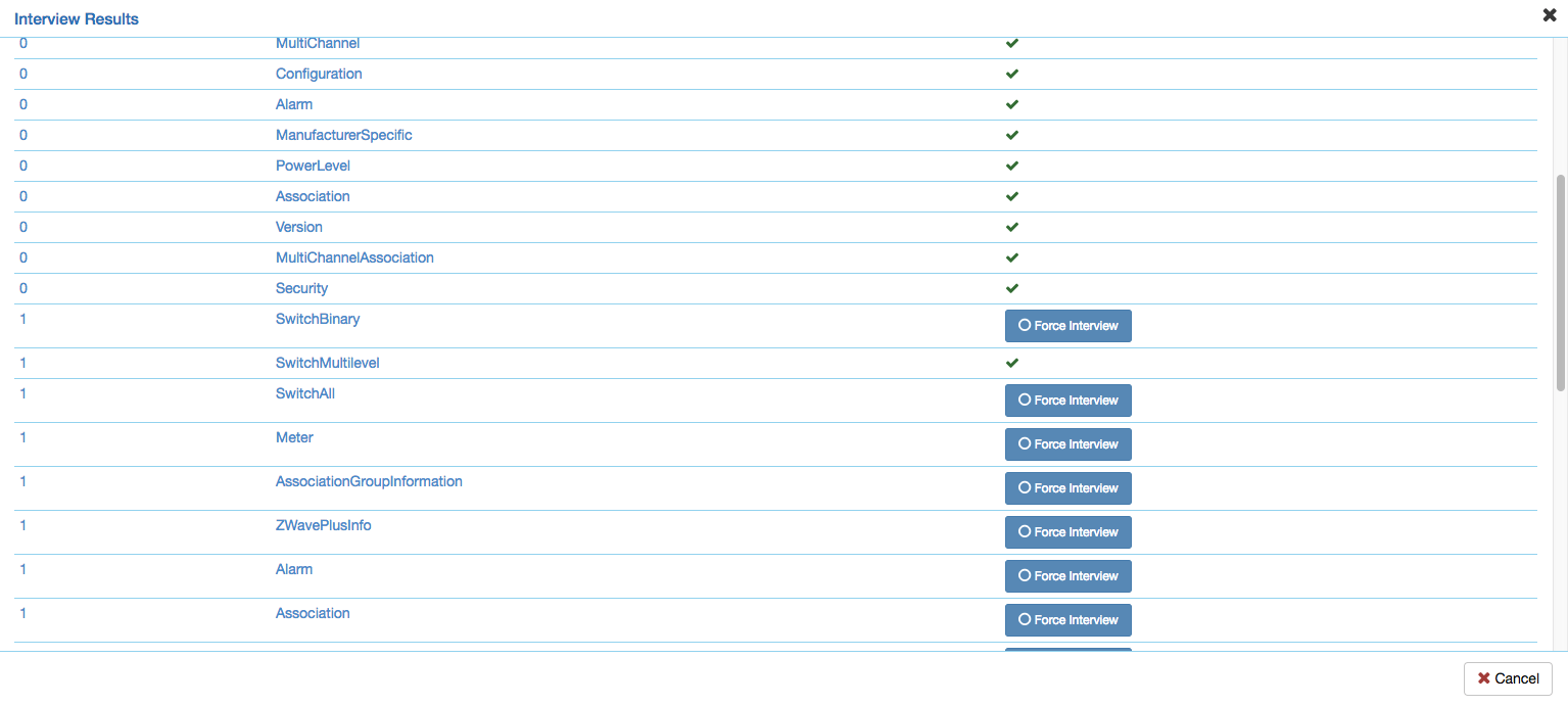

I've been searching for a solution for a while now. I'm having problems with the Qubino ZMNHDD1 inclusion. I've got 4 instances of command classes which seems wrong. I've had this problem for a while now with all tested releases, currently running v2.3.5-rc12 with SDK Version 6.51.09 and Serial API Version 05.07
Screen Shot 2017-07-05 at 09.03.47.png (86.56 KiB) Viewed 10264 times
This shows part of the interview, in my case the instances run from 0 till 3. The extra instances comes from the fact that I've enabled the extra l2 and l3 input buttons I guess.

which device version do you have? ZMNHDDX H_S_P_?
We have test it with newest devices and see not a problem. Interview is complete.

I've got a ZMNHDD1 H1S3P3 with secure mode enabled. Meanwhile I'll give the 2.3.4 version a try to see if the problem still exists.

ok we have test it with a newer Release Version from the device H1S3P4. I think it is a bug in the firmware from this device.

Thank you for the feedback, can you confirm that with the H1S3P4 version it works with secure mode? (Parameter 250 set to 1)? And l2 and l3 set to the binary sensor? (Parameter 100 set to 9 and Parameter 101 set to 9)? I needed to reinclude the dimmer to get the values processed.

Please follow instructions.
Include the device
Change Parameter 250 to value 1
exclude the device
include the device as secure
delete the Nodes on Associations group 1
add the Zway(Node 1) on Association group 1
Now is the dimmer is running.
