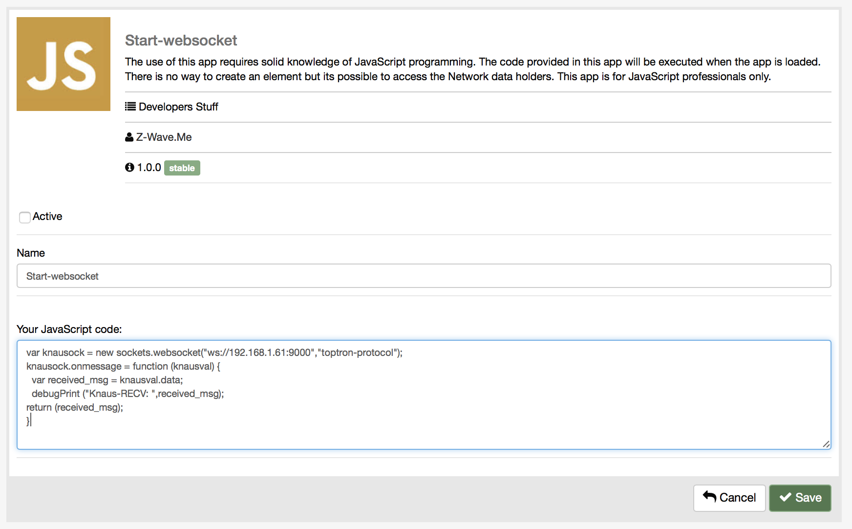

Hmm...okay. I think I just found a way how to reproduce it.
Interestingly it even seems to be related to my other websocket disconnect problem.
Here is what I did:
1. Login into zwave and go to Apps (where I used a JS-App to connect to my test websocket server)
2. Try to activate the JS-App which tries to connect to websocket (and unsuccessfully disconnects)
3. Logout of UI
4. Try to login again and then the problem occurs.
So it's related to the websocket situation...
root@raspberrypi3-jkl1:~# tail -f /var/log/z-way-server.log
[2017-08-12 21:30:43.586] [core] --- Starting module Load custom JavaScript code
[2017-08-12 21:30:43.741] [core] Executing script: var knausock = new sockets.websocket("ws://192.168.1.61:9000","toptron-protocol"); ...
