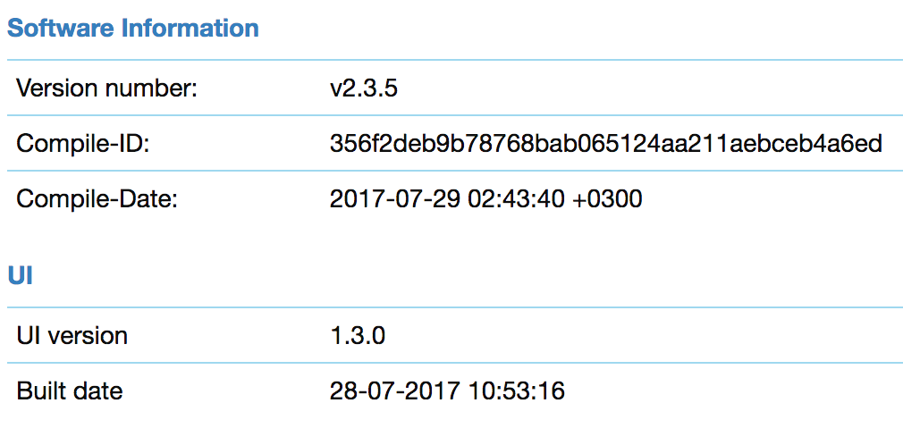

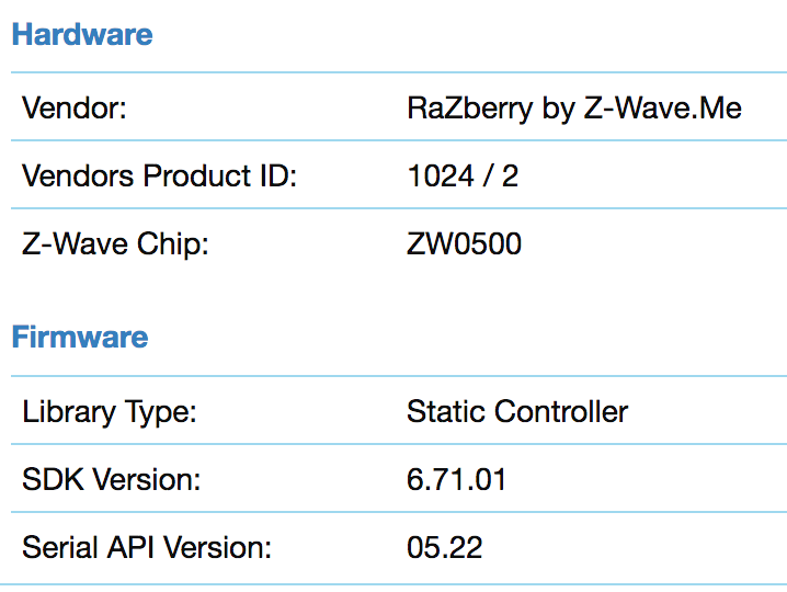

Hi Guys,
I've updated to the latest 2.3.5 firmware, and updated the razberry firmware itself to the latest available 5.22 as well.
This resulted in a new tab showing up in the expert-ui "Analytics".
However the added functionality there isn't very stable yet, I've managed to crash the z-wave chip repeatably by going to the "Background Noise" tab, the only way to recover is by completely powering down the raspberrypi. A reboot won't cut it.
After recovering, everything is working fine, as long as I don't mess with the "Analytics" tab. Exploring my log file shows an error related to the Background Noise function.

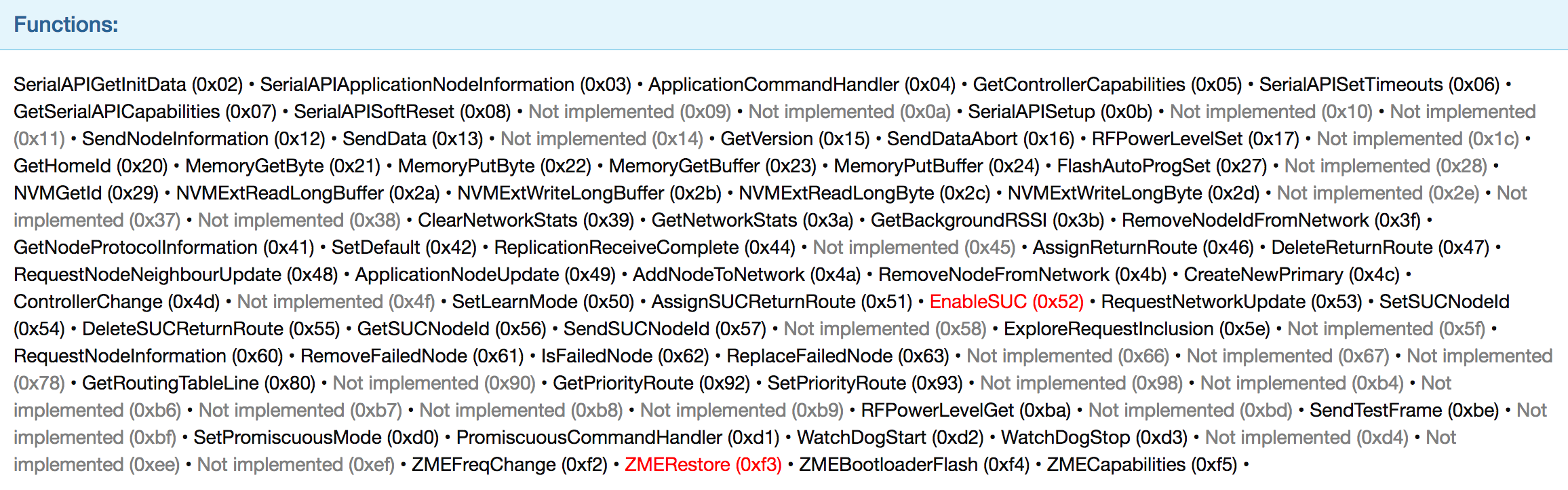

I'm wondering if anyone can point me in the right direction on how to resolve this, a number of screenshots showing the versions I'm running:
Hardware & Firmware
Hardware & Firmware

Functions
Functions
Screen Shot 2017-08-10 at 09.42.03.png (505.26 KiB) Viewed 15363 times

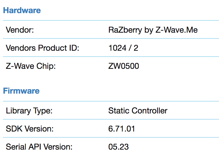

I was originally on firmware "05.07", when I was presented with the update to 5.22.
I've now updated from 5.22 to 5.23, strange thing is, there were 3 fw update options from 5.22. Two of them were 5.22 versions, the other one 5.23.
I've selected 5.23 and the update was successful, after updating to 5.23 the other two options no longer showed up, and according to the web interface I'm running the latest firmware. Just to be sure I did a full power cycle (Actually removing power from the device altogether)
However, the error remains..... Below another snippet from the log and a screenshot showing my razberry running 5.23.
Screen Shot 2017-08-19 at 16.45.35.png (51.78 KiB) Viewed 15242 times
Please advise.
