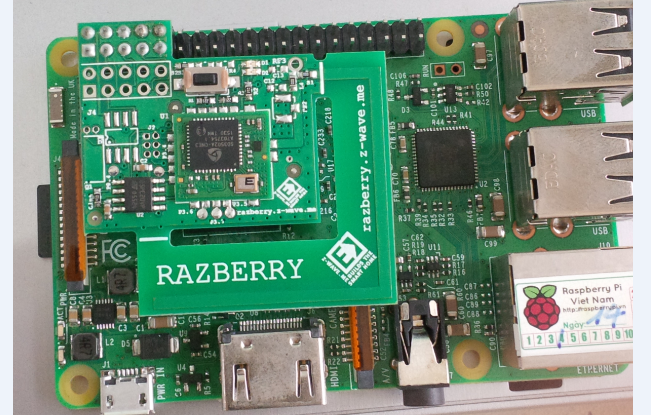

I am beginnger with z-wave and installed Z-way on raspberry Pi 3 with razberry card

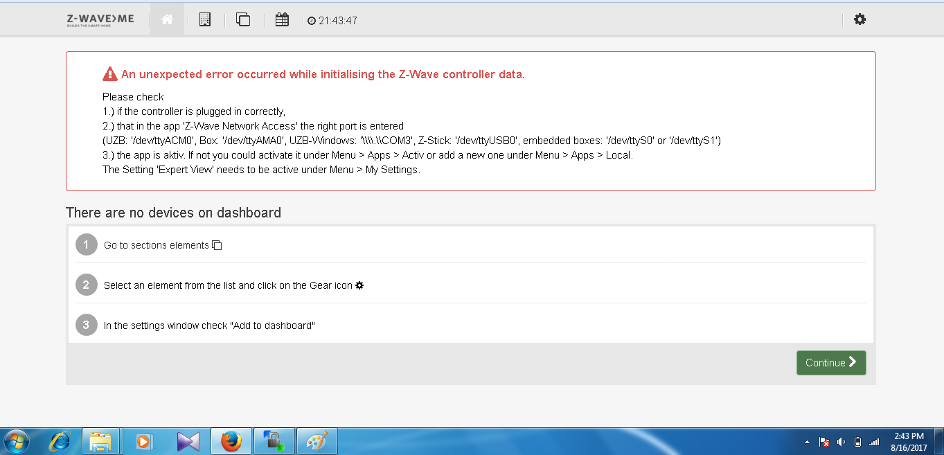

but i have error
An unexpected error occurred while initialising the Z-Wave controller data.
Please check
1.) if the controller is plugged in correctly,
2.) that in the app 'Z-Wave Network Access' the right port is entered
(UZB: '/dev/ttyACM0', Box: '/dev/ttyAMA0', UZB-Windows: '\\\\.\\COM3', Z-Stick: '/dev/ttyUSB0', embedded boxes: '/dev/ttyS0' or '/dev/ttyS1')
3.) the app is aktiv. If not you could activate it under Menu > Apps > Activ or add a new one under Menu > Apps > Local.
The Setting 'Expert View' needs to be active under Menu > My Settings

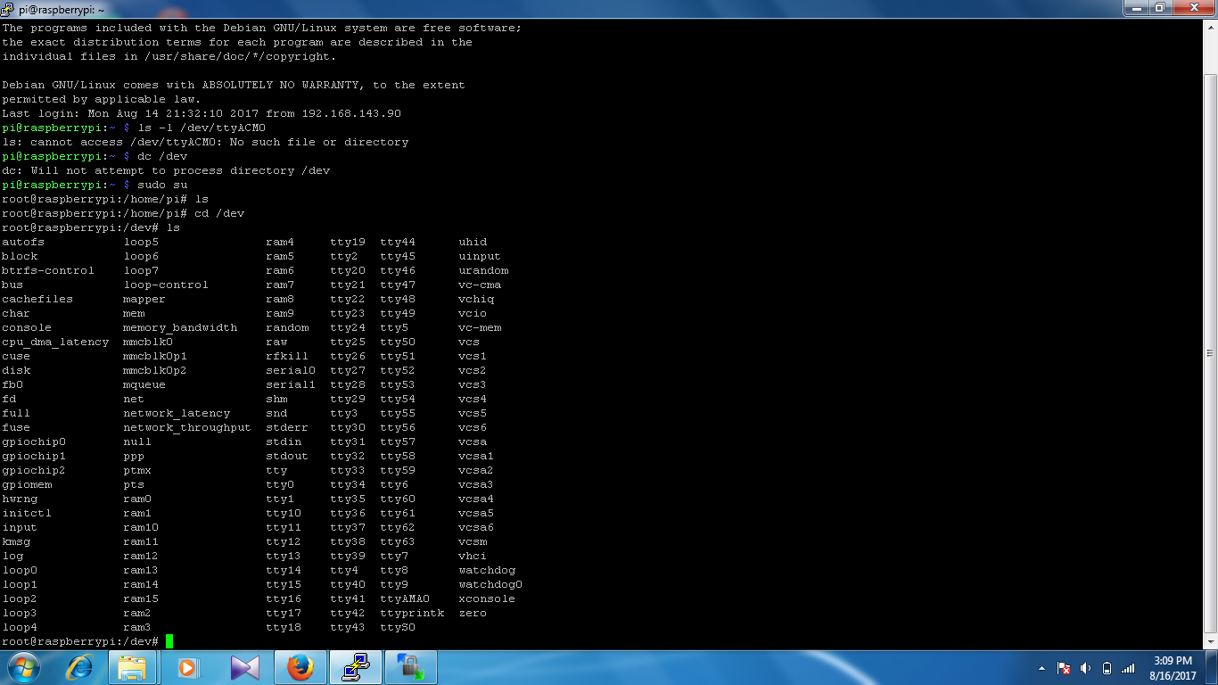

on my raspberry in find /dev/ttyAMA0 b

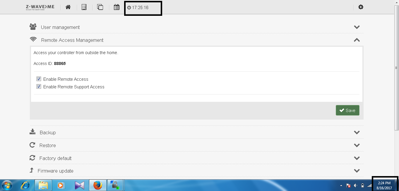

and the time in my zway is incorrect how to chage it

How do you have install the zway software and have you deactivate Bluetooth?
Is the red LED on Razberry on or off?
The Time you must set in your raspberry pi.

Re: razberry on raspberry pi 3
Bluetooth and razberry using the same Port.
The simplest variant is install the Z-Way software with command
wget -q -O - razberry.z-wave.me/install | sudo bash
on your pi, then will deactivate this automatically.
Best regards
