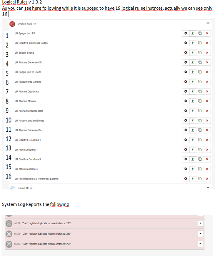

Hi, after app update to v 1.3.2
Is there a way to fix this before the next zway update?

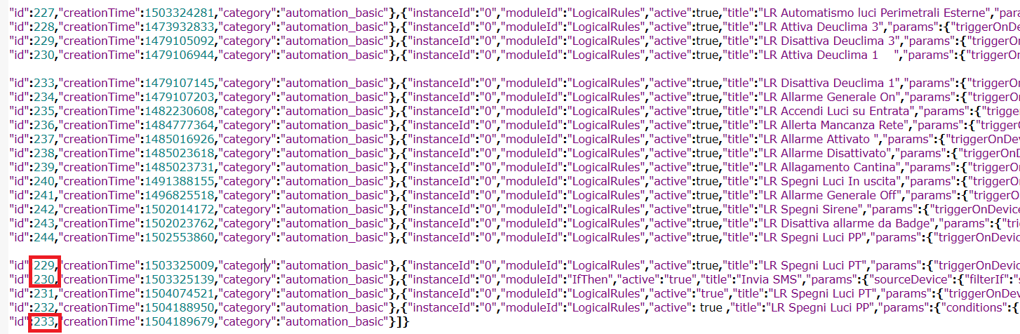

It seems a wrong duplicate Id in the configuration file
I'll try to manually clean even if I do not know jet which is the correct reference of the id....
I mean is it a prefix (As I swowed) or a postfix?

OK, May be a problem with Clone Button. There is something that goes wrong when you try to clone an instance.
We'll make some check as soon as possible.
Meanwhile if some one would contribute it will be appreciated
Marco
Re: Logical Rules App v1.3.2 problems
Make them as a sequence (245, 246, 247). Pretty strange how has this happened....

Dears GoodMorning. The problem seems to be solved (not 100%) but not the cause.
As per hypothesis problem seems to be generated by cloning button of the app
For some reason, this button has cloned also the id of the app instance and system went confused.
(with previous release of the app this never happened)
At first we try to modify id as per short indication…thinking about how interpreting that. Changing only cloned id generated a disaster. In fact reading at the above figure, new sequence was
Id244
Id245(previous cloned id229)
Id246(previous cloned id230)
Id231
Id232
Id247(previous cloned id233)
What we understood is that system wants singular id and probably also in sequence (but not sure) because Id231 and Id232 probably gave it problems to resolve the instance of the app.
Reading through the single line configjson-xxxxxx.json file is not immediate.The above image let me to hypnotizing something but I was on the wrong way because id is not a prefix and not a postfix. (I confess, I’m not a json exper) Anyway with the help of a json beautifier and some specific tool it was possible to format the file in a human readable way. In this way we could state that a LogicalRule instance is something like the following
