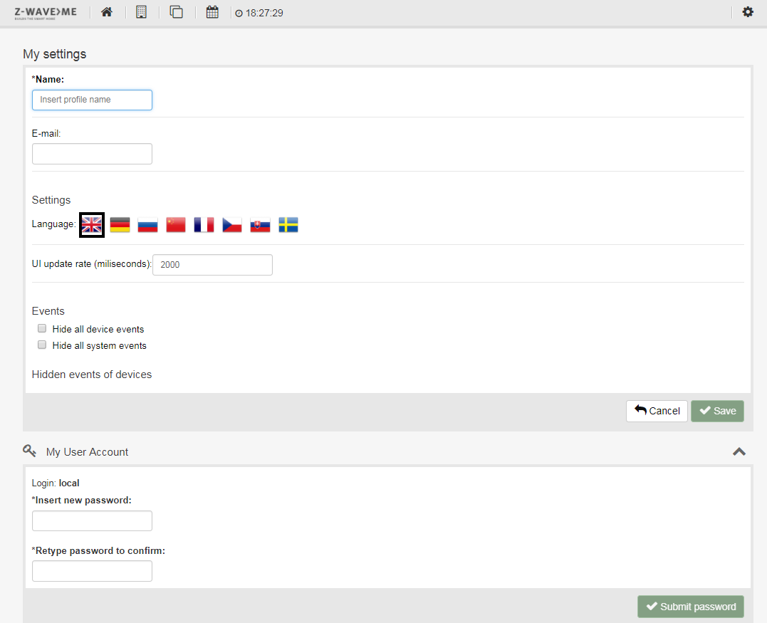

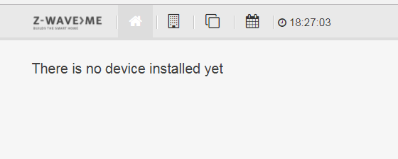

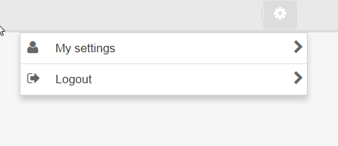

I bought a UZB1 USB-dongle, but I can not login to it.
Please se pictures for more info.
I was loged in once, but now I can not enter it at all. Anyway I can reset it?
Thank you for any ideas of what to do :)

You need to login as admin and change your Z-Wave dongle from /dev/ttyAMA0 to /dev/ttyACM0
