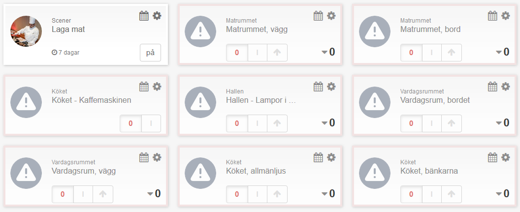

After a power outage, the normal icons in the UI are replaced by warnings, see image. The system is working as usual but I can not find a way to reset the icons to their normal state. Have tried restarting the server as well as restarting the Raspberry Pi.

I've had same issue. Try next: go to Customize -> Local Icons, then click Select Icon, and then click Delete Checked. After that install new Icon Pack from Online Icons. This may help.

I did a NIF but that did not change the icons, any other idea?
Just to be clear: The server communicates with the devices as usual. I can control the lights so the communication is ok but still the icons signals a problem...

Yes, I tried that but they immediately reverted to the warning icon. Before I reinstalled the icons one (only one) of the 16 devices I have all of a sudden reverted to the normal icon and have stayed normal since. Odd behavior... To the best of my knowledge, I have no issues in the network, the Noise Meter reads -79dBm and -88dBm for Channel 1 and 2, respectively.

Also in my case some (but not all) of the devices returned to the normal state, but after switching off (and back to on) the power of the whole house, several went to the failed state again; and they did not revert to the normal state, although all devices are fully operational. Changing icons, doing an interview or requesting a NIF did not solve the issue.
I resolved this by stopping the z-wave-server process, and editing the configjson-xxxxxxxx file: I replaced all "isFailed":true by "isFailed":false, and starting the z-wave-server again. Now all devices are OK. Ik looks like the "communication state OK" is not processed correctly?
