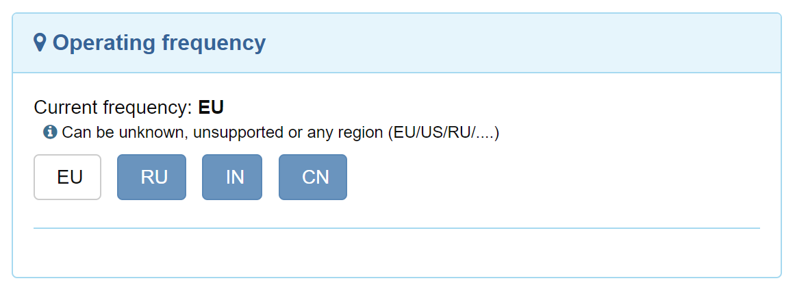

I purchased a Razberry V2 card from a local supplier in Australia.
The card arrived set to the EU frequency and I can't set it to AU in the expert interface.
I tried restoring my Z-Wave network backup from my Razberry V1 card which didn't change it either, I've updated the cards firmware and Z-Way to the latest versions "05.23" firmware on the card.
What do I need to do to get this card working on the correct (AU) frequency?
Below is a copy paste from http://192.168.0.5:8083/expert/#/network/controller "Show Controller Data"

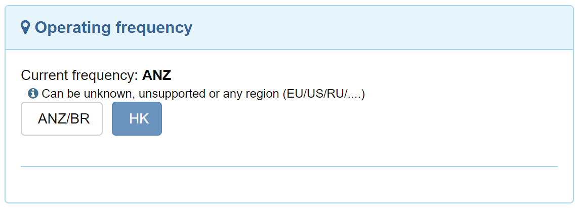

Solved
1) Login: http://ZWAYIP:8083
2) Enable debug mode: http://ZWAYIP:8083/expert/#/network/controller
3) Go to this URL: http://ZWAYIP:8083/JS/Run/zway.ZMEFreqChange(4)
You should see "null" response, then check Expert UI and it should look like this:
Then disable the debug mode.
Can confirm the card is working on ANZ frequency now, would have been nice not to have to waste 3 hours figuring this out on my own.
