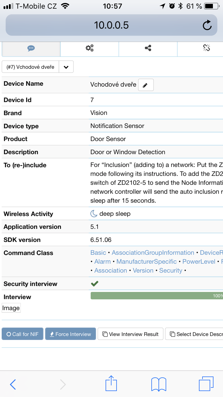

Hello I am using multiple Vision Security Door Sensors ZD2102EU-5 (Z-Wave version: 6.51.06, FW 5.1) and I am struggling two problems:
1. One of the sensors when I reboot Smart Home Center sets its state to On, even when the sensor is still off and door is closed. Opening/closing the door will correct the state of the sensor, but I don't know why this happens only on this one sensor.
2. Sometimes the change of state is not registered, it happens randomly on all sensor, sensor will flash that it is sending information to Smart Home Center, but in UI of Z-Wave.me there is no change of state, even in Expert UI. What can cause this and how to prevent it?
I have Western Digital EX2 + Z-Wave USB (ZMEEUZBWD), Z-Wave.me version (v2.3.0), I have all device Z-Wave Plus and link strength for all devices in Expert UI is Green (don't know why sometimes it is gray).
Thanks in advance!

It seems, that when sensor is not responding it is in some deep sleep mode regarding the Expert UI, it is even not blinking when I open/close door, so the change of status is not transfered. When the sensor is awake, it works perfectly. How can I avoid of this strange behaviou? I want it to be working always, not only when it is awake.
