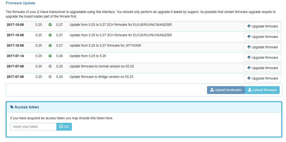

There is a way to update the firmware without Z-Way for example by using command line? Like I can change the frequency using a shell script (changezwf.sh).
I ask about it because I'm not sure that Z-Way updates my UZB correctly. I tried to update the firmware several times but 'Controller Info' and 'Firmware Update' pages do not change their state (I expect that after update Serial API Version will be 05.27).

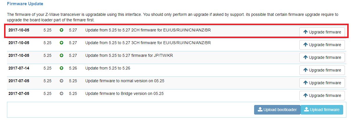

Re: SerialAPI: Command: 0xa4 is not supported by this SerialAPI
You need the last option in the picture

Do you mean this one?
No, last one. You want bridge, right?

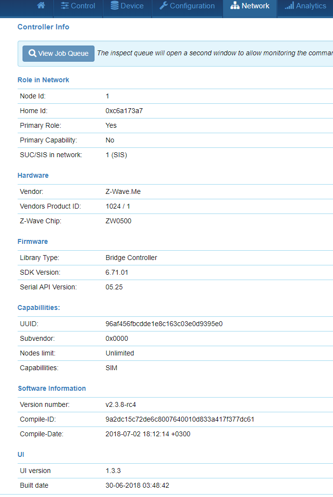

Yes, I want the bridge version. Regarding that you offer I did it several times and I've just done it again to be sure. Nothing changed: the firmware version is the same as before update (on 'Controller Info' page), the list of updates is the same too (on 'Firmware Update' page). And Z/IP Gateway still does not work (the same errors in log). P.s. What do green/gray icons with arrows inside them mean on 'Firmware Update' page?

As I described before I updated my firmware several times. The last time I did it I saved Z-Way log file (see attachments) in the hope to find something in it. This log captures the time from Z-Way daemon startup time to the moment when Z-Way said that the firmware had been updated. As I can see there are no errors in it except JavaScript exceptions. Also 'Controller Info' page says that I have 'Bridge Controller', SDK v6.71.01, Serial API v05.25 (see the image above). So I can conclude that I have the latest version of the firmware. And with this version I have the problem with Z/IP Gateway. So that I think that this firmware does not support some part of Z/IP.
Could you provide a list of the commands which are implemented in your firmware?
