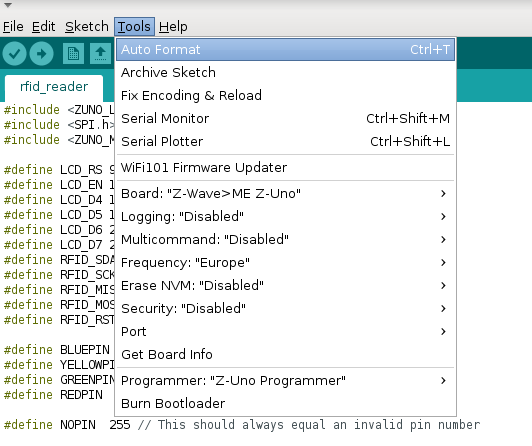

IDE Settings:
Board: Z-Wave>ME Z-Uno
Logging: Disabled
Multicommand: Disabled
Frequency: Europe
Erase NVM: Disabled
Security: Disabled
Programmer: Z-Uno programmer
Additional Boards Manager URLs: http://z-uno.z-wave.me/files/z-uno/pack ... index.json
