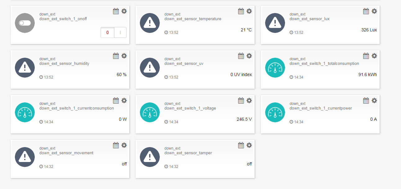

One problem I am having since 2.3.8 is that most of my zwave battery devices now show as having failed after the server has been running for a while (I'd estimate a day or so). The icons show a ! and their status in the API isFailed is true.
They are still updating as normal, with the timestamp underneath showing that most of them sent data within the past 30-40 minutes. The icon is just stuck in isFailed mode.

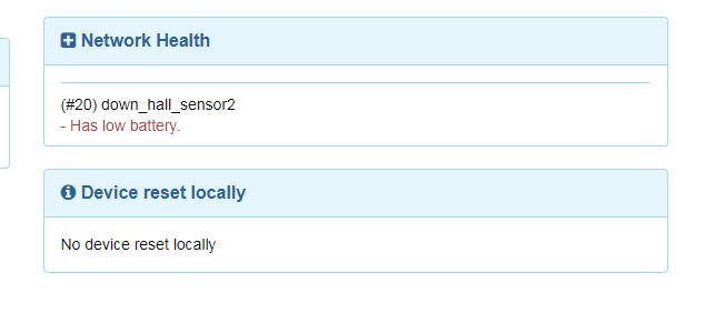

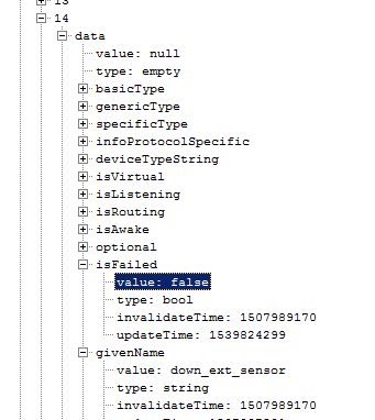

In the expert UI, everything looks okay and no failed zwave nodes. Also the /ZWaveAPI and /JS/Run APIs do not show the nodes as failed. There are no failed nodes listed in the Network section of the expert, and the health does not list any as it has in the past if a node has failed. It just seems to be in the /smarthome frontend.
