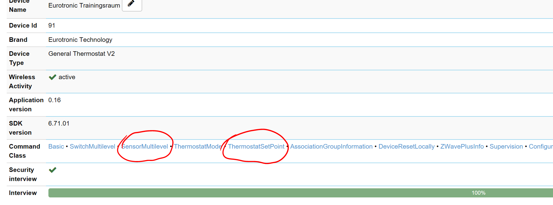

Forgot to say you need to look up the part, wich i dont know about your device. Go into expert view, device=>status=> your desired stellaz device. Now check the corresponding command classes and you will be able to create a "link"
I attached a screenshot from one of my eurotronic devices. In these commandclasses i found the right values for your case. Maybe its similar?
Example for my thermostatsetpoint:
zway.devices[91].instances[0].ThermostatSetPoint.data[1].setVal.value
Because under 1=>setVal my set temperature is listed
