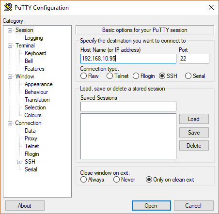

  1. open a SSH client like Putty to connect to your hub by SSH
    Users of a Popp Hub 1 may find the ssh password in a file called password.txt stored on the boot section of the SD card. To read it out make your Popp Hub powerless, remove the SD card and put it into a card reader (maybe you need an adapter for micro SD card too) to read it out on your computer. Open the directory of the SD card and write down the password from password.txt. Eject the SD card and put it back into your Popp Hub 1 - be carefully sometimes the card can slip between the tiny slots and you need to open the case.
    Enter the IP of your Hub and click on Open
    GUI of putty
    GUI of putty

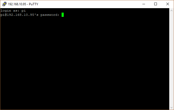

  2. enter your SSH credentials to login
    Popp Hub 1 user enter
    login: pi
    password: [the one taken from password.txt]
    ssh login on hub
    ssh login on hub

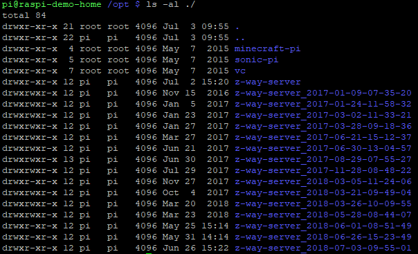

  5. list all z-way-server folders within /opt directory
    $ ls -al ./
    ssh login on hub
    ssh login on hub
    The folder z-way-server is the current server and it's predecessor is the one with the most recent date.
    In our case z-way-server_2018-07-03-09-55-01

list of all installed and backed up z-way-server
