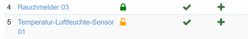

3. security
Under device --> type info I see orange open lock symbols of Z-Wave Plus devices. What does that mean?

- orange open lock symbol
- 2.PNG (9.63 KiB) Viewed 23826 times

3. This product was not included with security, sometimes there is different way to include secure. E.g.: press 2 times including button and not 1 time.
Also, it may not support security, even it´s zway plus

3.
Regarding my Aeotec Range Extender 6 you’re right. I had to push the button twice. Now it shows a green lock symbol too. But the manual of the Popp mold detectors, which support security v2, only names one way for inclusion: pushing the tamper button three times and it should automatically work in a secure mode if the central supports security. I’ll ask the manufacturer about that.

3. S0 is yellow, S2 is green, non securoty is red

2. This means that the packets’ runtime is the only reliable information one can get from this page? Then I’d suggest to remove these colours and legend text because it seems misleading to me. The communication didn't fail and no routing was possible.
3. According to their manufacturer these sensors POPE701202 do support S2 security. But only S0 was applied during inclusion. What might have gone wrong?

3. If you are on v2.3.8, it does not support S2. The v3.0,0 does

3.:
Now that z-way v3.0.0 is out I tried again to add a Popp mold detector POPE701202. The device type info page now shows “S2 Unauthenticated“ and two lock symbols, one green and one grey. I assume that two green lock symbols will represent “S2 Authenticated” status. How can I get that? A PIN an a QR code are printed on these sensors but how can I enter the PIN in z-way during inclusion? There was no form, no window to put that in.

Only in Expert UI you can do this. And only if the device supports it. Please try and it will show all security levels the device requests for

When I include the device using the Expert UI a dialog comes up that asks for the security level but only S2 Unauthenticated can be selected. Then a long key shows up whose first five numbers match the PIN printed on the device and I can confirm that.
I read again in the device‘s manual and it says „The device supports the Security S2 framework with unauthenticated network keys.“.
Conclusion: A PIN printed on a device does not necessarily mean it supports S2 Authenticated. That was what confused me at first

Correct, one can print the PIN to still allow you to verify it
